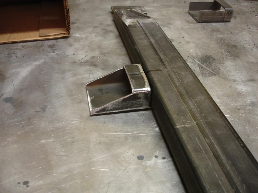

During the test fitting I found the old trans cross member wasn't goin to work. unless I drilled new holes and flipped the perch on the opposite side. which would have been fine, a pretty easy task. But of course I got this idea in my head that I could just build one myself. I think it was mostly cause I just wanted to weld on something. So I bought some metal and went to it.
here's the issue
So I started with a 3' piece of 2x4 and 4"x12" steel plate
I cut these out of the plate
Just to get a first look at the comparison or what I'm doing
Drilled some holes which i'll weld up
I slit the sides and used c-clamp to press this down and welded it.
originally I was going to cut off the sides but I decided to bend them over and weld them thinking it would make it stronger.
Garbage looking weld ^^^ I could not keep the wire from sticking in the tip. driving me Freaking crazy! (I'm glad I got it fixed now)
Both sides done and compared to the old one
I had to bend it down so it would clear between the floor and subframe. you can see they are pretty close to the same. I figured if the original one fit under there Thats how I should make the new one.
Here is the transmission perch I made.
Perfect fit!
I think it came out all right it looks a little funky. I think I'll call it my "first draft". perch is at the same height as the original, which is almost level with the top of the subframe. however I don't know if it's at the right spot for the 4L60. I'll check drive line angles when I get the subframe on. I'm sure I'm going to have to adjust it. The transmission may not even clear the tunnel at that height. but I'll cross that bridge with it comes. made this one as close to the original one as i could.
