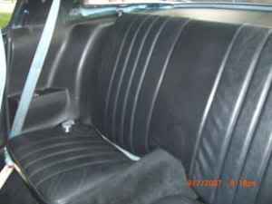

Another option I have is a grinder with a cupped wire wheel on it. It would do it, probably take just as long too. Question is, will the grinder setup like that be safe to use on the sheet metal? Setup like this?
After that, I can POR15 the inside floor and outside floor, plus the frame. Still need to get a pan for under the passengers rear seat though.
Might have found a good set of seats on craigslist. That would leave me with a set of tan ones in OK condition, but probably needing recovered.
