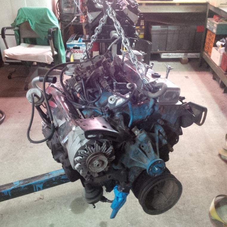

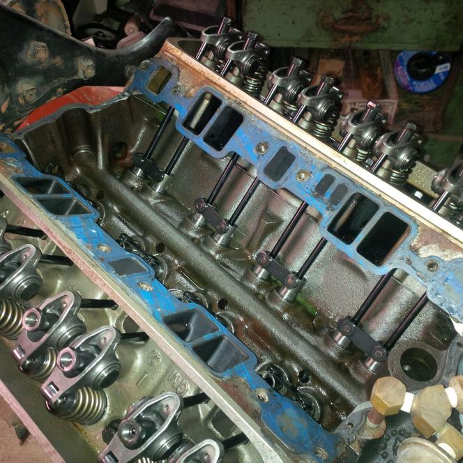

I"ve owned this Camaro now for approx3.5yrs. That's when my father sold it to me for a dollar. Its been in the family since 82.
I'm slowly changing it the way I've always envisioned it and the first thing was the rear wheels and tires, now I'm working on changing the weak oil burning 305 over to a nice mild performance 355. Old motor is out and the new motor should be going in this weekend. Then the trac bars are next along with the rear sway bar that I bought from a guy at work for cheap, they just need paint.

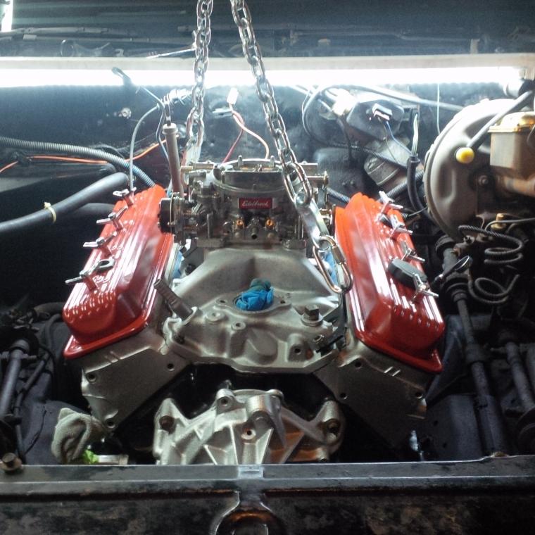

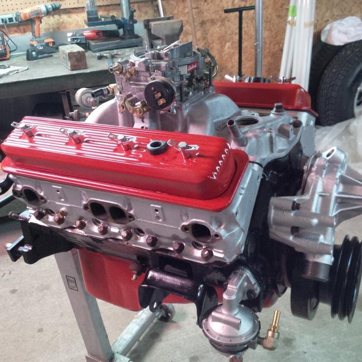

Heres some pics of the new motor I built.
