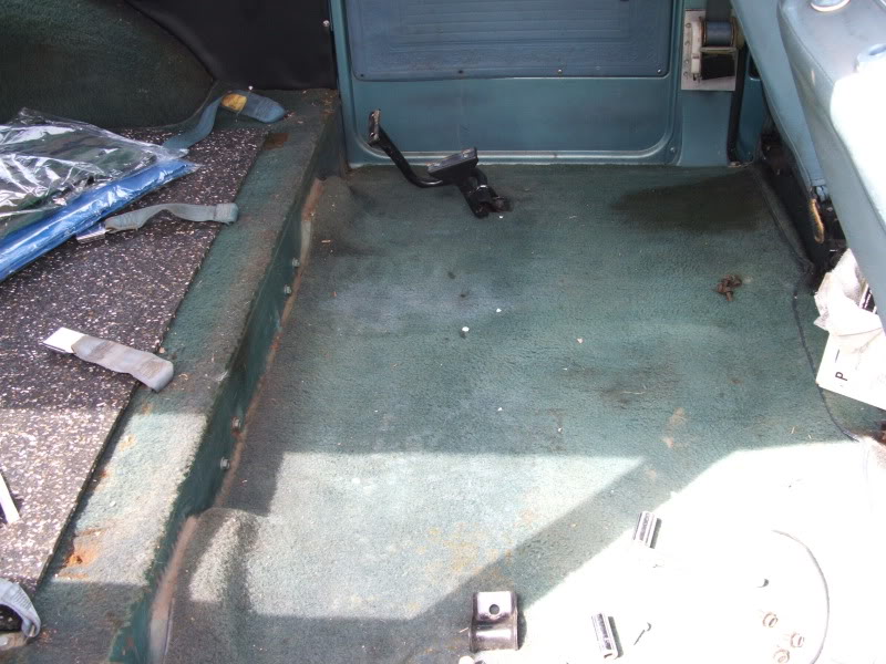

Pulled out all the old carpet under the seats. (still have to do cargo area, but that will be a snap) Cleaned and prepped everything.

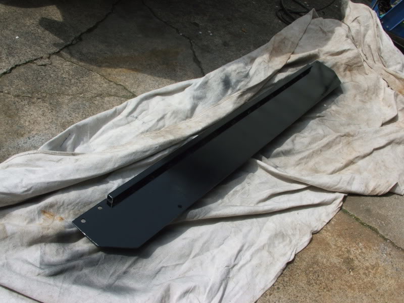

Laid down sound deadener. Removed the old frame supports from the backseat, and relocated them, then built a plate to span the new bolt pattern for the Durango backseat. Welded up a piece of box tubing on the back side to keep it ridgid, and add strength:

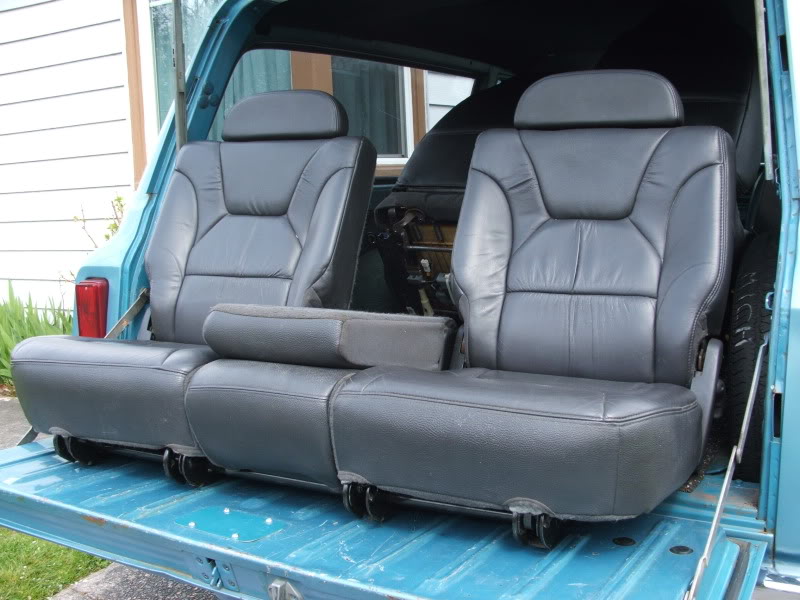

After bolting the plate to the supports, I laid the new seats on the frame and marked the bolt holes. New back seat:

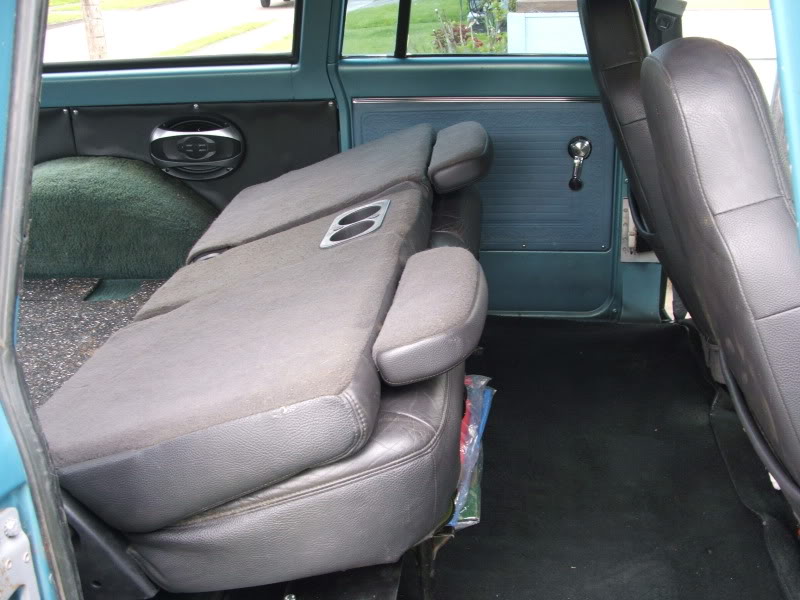

The new seat lays down to allow more cargo space if I need it, or just look cleaner if I want it down:

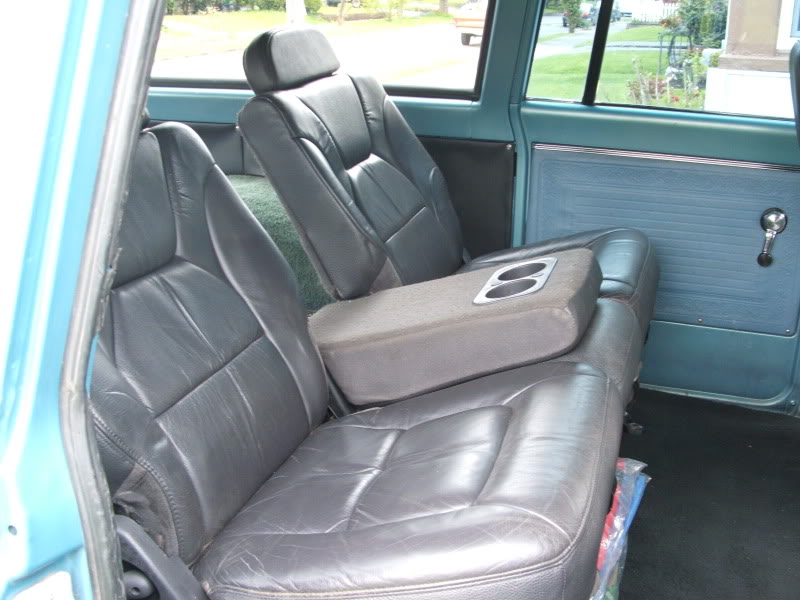

Saved the buckets for last, as they would be easier. Had to add a small L bracket to the front of each foot to make it bolt horizontal, instead of perpendicular to the floor. Just used a Kindorf L bracket and then marked the holes to drill with white chalk. Bolted the seats in after cutting the electrical plug off the driver's seat and adding 5-6' of wire to run to the fuse block. Fished the wire in and bolted the new buckets down:
Hooked up the wires to the fuse block, and cleaned up the driveway full of tools and welder! Here's the new setup:

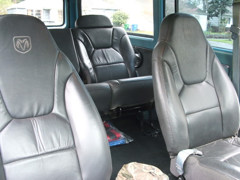

The new buckets are really nice! Dark gray leather, with adj. lumbar support, and electric 6 way controls! Gotta go to the U pull it tomorrow and find seat belts to match the seats, and then it's done!
Only bad part is that Mopar Ram on the headrest of the buckets. Hard for a diehard Chevy guy like me to see that every time I get in!
