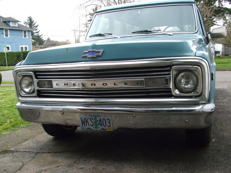

I got outside with the tools today and tore the grille out of the Burb. The plastic egg crate section was toast, and I picked up a chrome tube grille at the swap meet for $5, so I figured I'd see if I could fit it.
Problem was the tube grille was for the later Chevy trucks without the ceneter bar, and I didn't want to cut my center out. Decided to get the die grinder out and start whacking on the $5 grille instead. I cut the welds that held the center 2 tubes, and left the 3 above and below that. After cutting them out I test fitted the grille, and decided to set it back slightly to give a nicer look. Got the brackets out that attach it to the core support, measured the distance and chopped a couple inches off them.
After all the cutting and drilling I painted all the supports and brackets, then set the grille behind the stock grille, mounted the brackets, and then bolted the grille to the brackets. After some adjustment I got it aligned and then tightened it down. Reinstalled the hood latch, latch support, and turn signals.
Sure looks better than the stock broken grille, and gives a little more bling to the frontend without getting too custom.

^ . . . dude how many toys do you have hehe great looking truck.

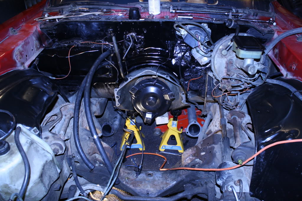

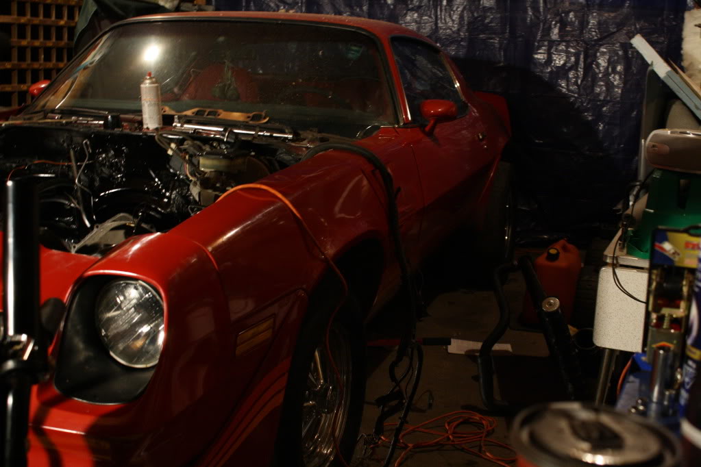

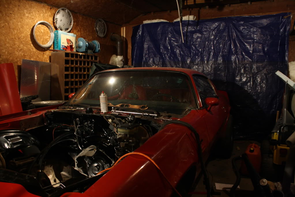

Heres some shots before i put my motor back in.
