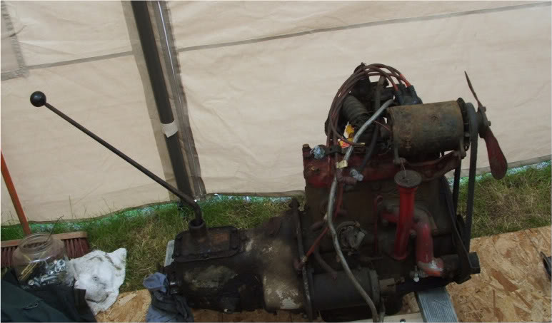

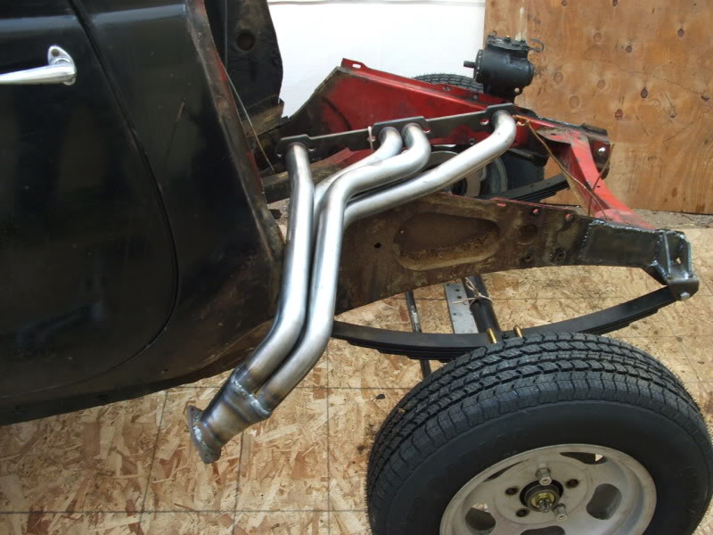

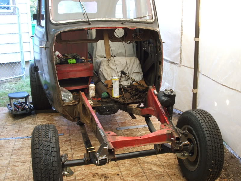

Pulled the old 8 hp flathead 4 cyl. and cut the firewall out. Stripped all the brackets off the frame and mocked up the headers to see if I need to disect the frame to clear the fenderwell headers. Looks like I might, but I'll wait until I drop the 327 in to see how much.
Made a trip to the U-Pull It for a Mazda PU truck steering box. They sit outside the frame, so that will help keep the engine clearances good! $35 is also way cheaper than a Vega box!
Old 4 banger:

Freshly cut firewall. Need to recess it too for engine setback:

Header mockup:

Lookin good. Do you know much about the stock Austins, like why they kicked the frame over to the side like that?
Old Sep 19, 2010 | 09:05 PM
  #139
I've had a few friends who owned and built A40's, but those are the next generation after mine and have a regular frame with body bushing mounts. Really not sure why this generation chose to use a peripheral frame on the body. It's definitely stout, and has multiple crossmembers, and X members aound the tranny and back by the rear axle.
I'll be adding a couple more as the new engine/trans, and ladder bar suspension go in to hang everything. It will add some weight, but it's light enough to not be an issue.
