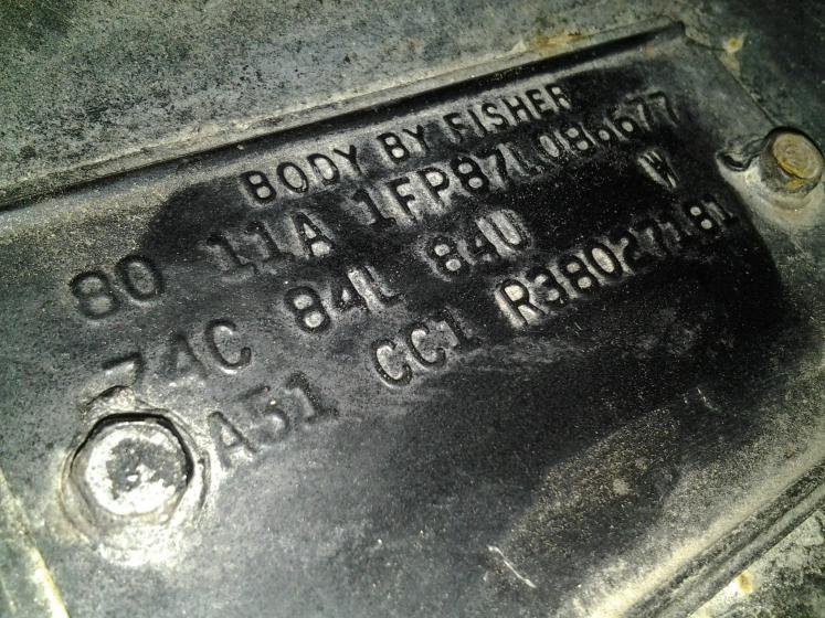

Ive decided to get a little more info on my car's history and was looking at the VIN # and i cant match it with any database... WTF? its 1P87LAL525763. The trim tage is throwing me a curve ball also... here is a picture of the trim tag.Weird VIN #?-2012-07-29-14.24.31.jpg
Any ideas?

To decode those numbers go here... Chevy VIN, Trim Tag and Drivetrain Information & Decoding
You're right the VIN is out-of-whack.

The above link is missing some info (the P code for one)
Try this one: Chevy Camaro VIN Decode Second Gen
1 = GM
P = Camaro
87 = sport coupe
L = 350 engine, 190 HP
A = 1980
L = Van Nuys plant
525763 = build sequence
What with the trim tag is throwing you a curve?
