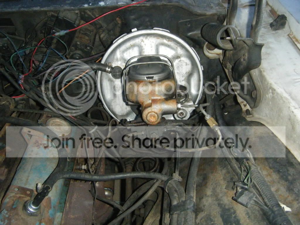

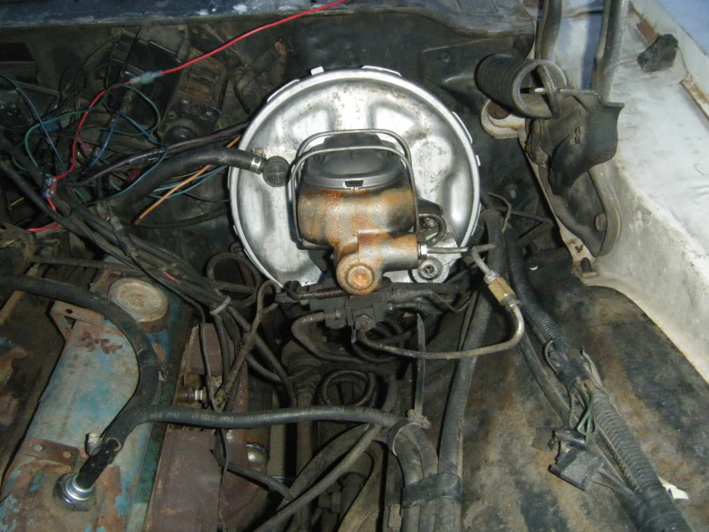

Don't take this the wrong way please, but I noticed in your brake post a lot of wires running outside the normal pathways. I think you may have some wiring issues you don't realise with all those extra wires under the hood. Does it look similar under the dash?
no is ok actually thanks for the help under dash is clean and the that red wire i got going the booster is a troubleshoot wire to give current to distributor or ealse the car wont start
