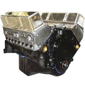

This is where I order most my parts. 410 hp $4000
This is a good long block for $3100

Staying with a smallblock will save a lot of money, because everything will bolt right up. The only thing to keep in mind is the transmission when changing from a standard 350 to a built smallblock. Be sure whatever trans you have will stand up to the extra power.

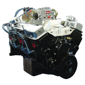

I guess my big dilemma is if i should buy something like this Patriot Performance 3832SD - Patriot Performance 383 C.I.D. 450 HP Engines - Overview - SummitRacing.com
or something like this
High Performance 350 Chevy Engines Custom Designed For Your Application
Old Sep 18, 2011 | 08:24 AM
If it's good to 450 hp, then it should work with both, but you may need a higher stall converter depending on what you have now.
