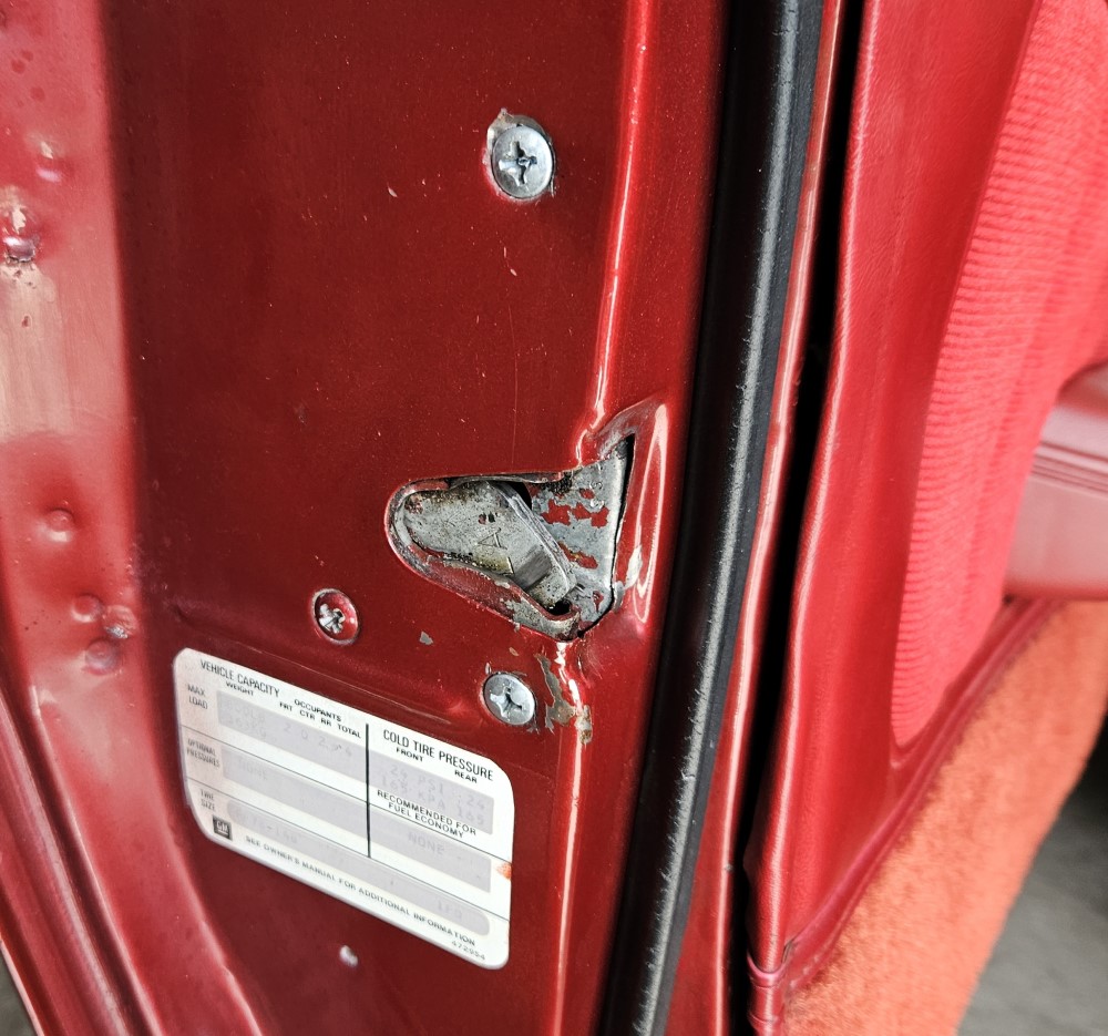

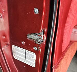

I've got a new issue now where the driver door doesn't always latch closed... I have to fiddle with the latch for 10 minutes and then all the sudden it starts working again. Scary drive home as I'm afraid the door will swing open as I'm rounding a corner. But that's a next weekend issue...

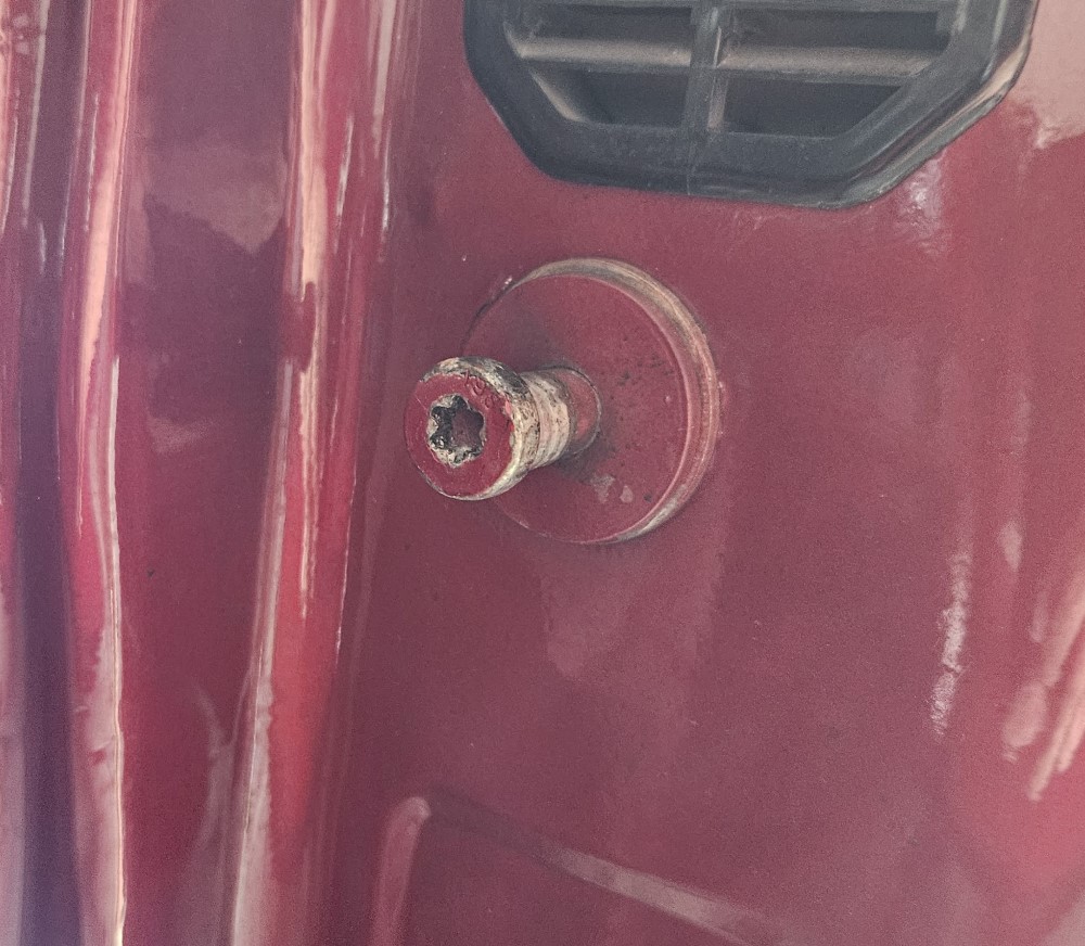

Second gens are notorious for sagging door this starts with the hinge bushing.. This means the striker and latch must align the door during the closing process. They where not designed for that. If you open your door can you lift from the back of the door to check the hinge for play. Also if you look at the striker how does it look? Is the latch bolts tight? To fix this first you repair the door hinge (they may need replaced). Then get the door adjusted. If you still have an issue I would replace the striker. Last thing to replace is the latch itself.
If the door is not sagging you could try some spray grease on the latch and re-adjust the door. (see youtube for how to adjust doors)
If someone "restored" this car they may have done some of the work for you. So maybe they fixed the hinges got it work decent and now the latch is a problem mostly because when the door was sagging it took some serious wear. Getting the door re adjusted can be a pain. If its your first time plan on it taking awhile. The hinges are very adjustable which means you can get in any car that was not wrecked but it also means getting it dead on is an art form.

Well, hinges seemed good. Doors don't drop upon opening and I can't wiggle them at all from the rear of the door. Striker and latch look like they have been abused in the past, but doing a sloooow close on the door they don't feel like they are binding at the moment. I snugged everything up and lubricated the latch. Made a tiny adjustment on the striker as it looks like the door wants to close in a little more. But so far seems to be opening and closing without issues. I'll replace the window felts probably in January (Christmas is hitting the wallet pretty hard) and take a good look at the latching mechanism then to see if it needs replacing.
