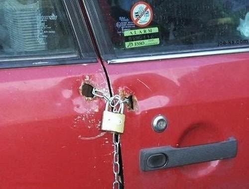

When it comes to security, nothing beats a good padlock...
Old Oct 16, 2010 | 11:17 AM
Don't bet on it, we all know your secrets now!
The Austin has no door locks. This may be a solution to locking them up!
Just paint the chain and lock the same color as the car and nobody will ever know haha,or better yet get them in chrome and just say they are accessories lol.
LOL I kept a couple secrets. Like the Kamoto Dragon sleeping in the front seat.
Growing up our niegborhood was so crappy that my dad had to do the same thing to the hood of his Scout II just so his battery wouldn't walk away.
