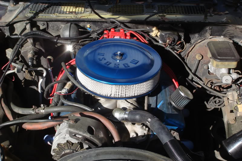

ok i will try that..but i dont really see a fuse box near the battery..sorry im really a wiring newb lol
here's a pic under my hood with the battery in the lower left hand corner

the back of your fuse box is to the right of and underneath your brake booster on the firewall. you should just be able to touch the negative to any bare metal under the hood and probe the fuse box with your positive.
if you aren't able to probe the back of your fuse box, go inside the car and do the same to the front of the fuse box with your positive on the fuses and your negative to a bare screw or something, the screws holding your door sill plate would probably be your best bet.
