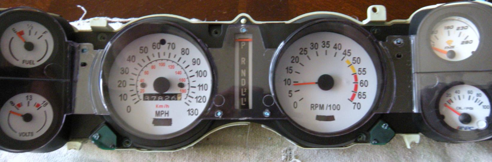

I really didn't want to have to swap gauges but I'm only replacing the ones that didn't work. I put a new temp gauge and oil pressure where the clock was and added some white face covers to the factory ones. There really aren't any wires that I'm worried about, it's the board being disturbed in that area. Guess there's only one way to find out. Just trying to not have to pull the cluster out back and forth as there's already 3 broken mounts on the cluster from whoever had it before and those plastic ears are really brittle.

To answer your question, no it won't hurt to move the circuit board out of the way. But I would gently tape it back down to the cluster so that it won't flop around and eventually crack and break a connection.

69, thanks for that. I've got the guages both mounted and I put plastic/rubber bolt thread tips on the mounting bolts as to hopefully not cause any interference or problems with coming into contact with the circuit board. The new LED bulbs should be here today so I'm hoping I can get this thing put back together before the weekend is through. Appreciate the help.

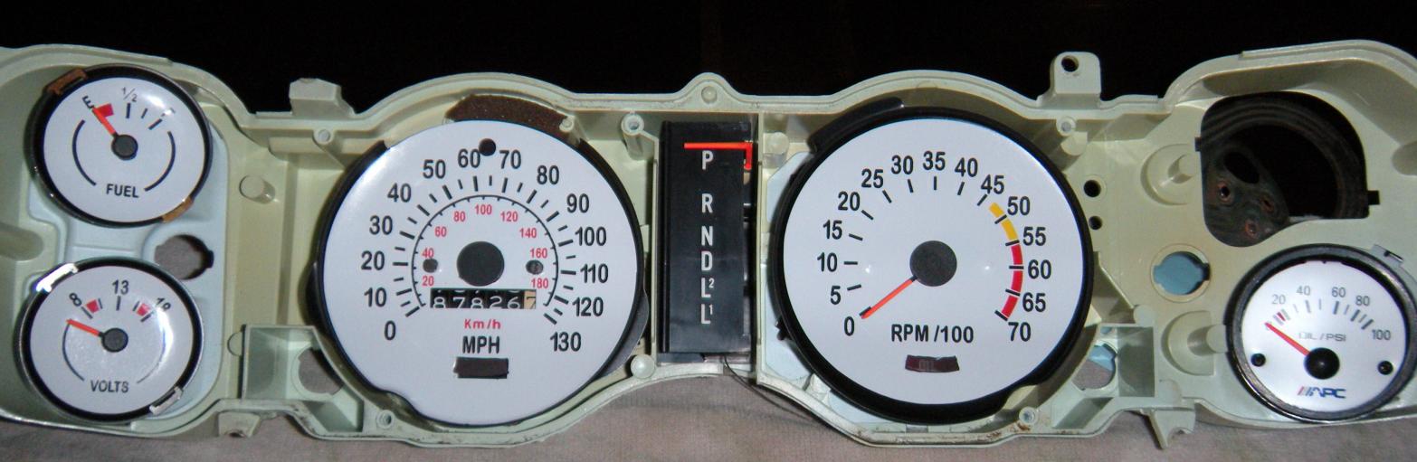

Actually, another quick question. Does the needle for the speedo come off just by pulling it off? I usually use a kitchen fork to pry the needles off of other gauges and have had no problems. I tried gently by hand and it seems like it's on there pretty good. Ended up breaking the speedo needle off doing the gauge face covers and it'll be a lot easier to re-glue if the center part is off the gauge.
