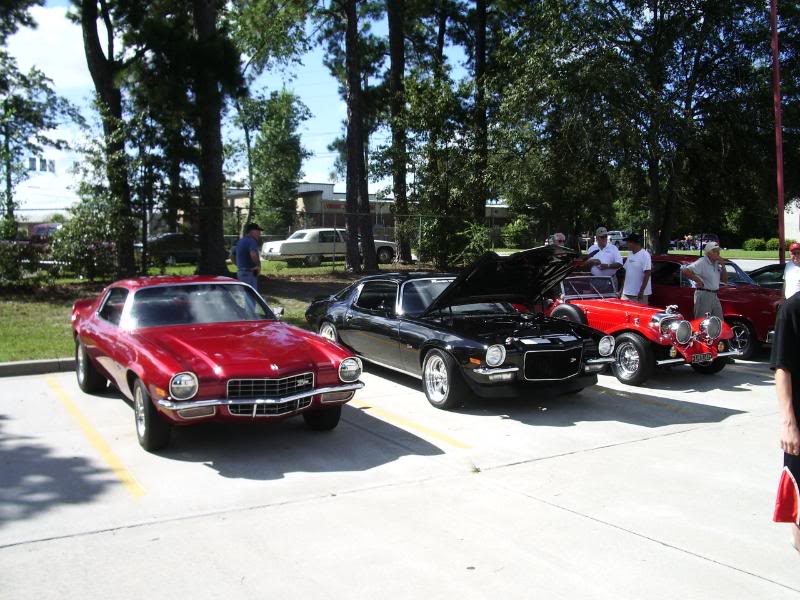

if it has rectangular parking lamps it IS NOT a split bumper car, As said, just a mod someone did, lots of people do it. Only split bumpers RS version had the round parking lamps.

Look at Y2K's picture. The split bumper grille has a vertical bar in the center, and the center section of the front nose has an extension piece that protrudes the center further out (you can see the seam). The differences in the marker lights has already been mentioned.
Old Oct 7, 2009 | 05:22 PM
The grille's center piece is hard to spot, as the divider is painted to match, but it's there. The nose extension is about 2" deeper than the stock sheetmetal, and made of plastic.
