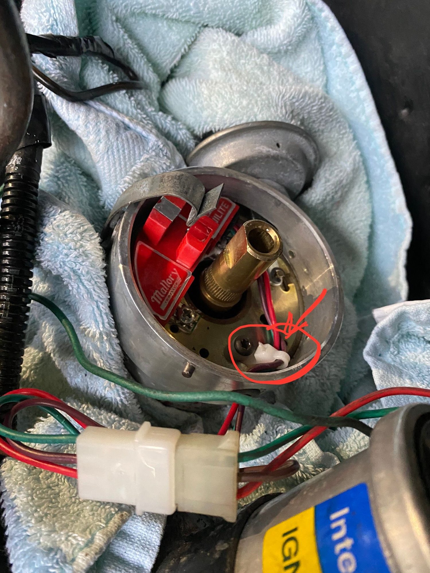

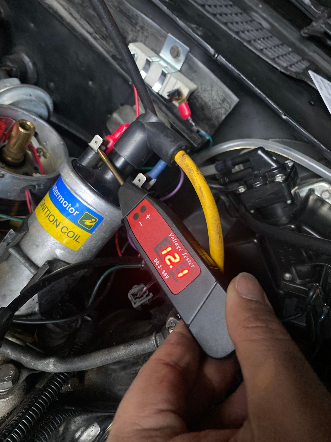

Pls help !!! Cranking but wouldn’t fire up. 3 to 4 volts at coil and no spark.
That distributor is not stock
Looks like a unilite or some other points delete distributor

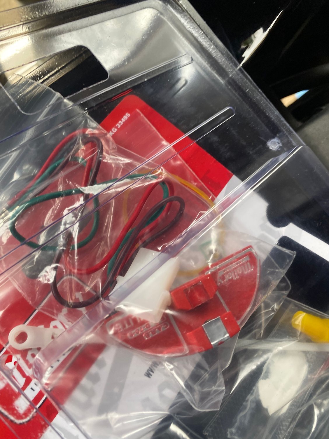

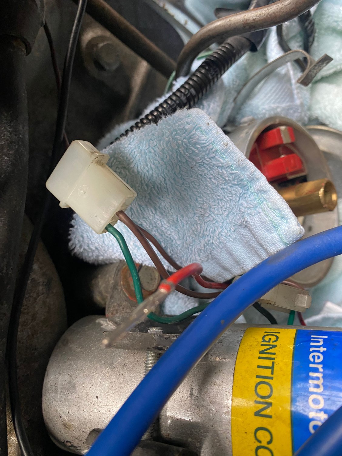

And, I wanted to also update you that my issue has finally been resolved. I wanted to share with you what the issue was. It was the electronic module within the Mallory Unilite Distributor. The three wires of the module within the Distributor body were slightly ripped/peeled and somewhat broken, mainly near the ‘cable tie’ that was holding the wires screwed to the base plate of the inside of the distributor. How I came to know this? One of my friends looked it up on internet, and he found instructions to test the Mallory Unilite Distributor electronic module. We checked the voltage at the coil, and then blocked the optic sensor of the dizzy module with a plastic credit card, and checked the voltage at the coil – the voltage should drop in case of an functional module, and would remain 12 v if the module is faulty. In my case, the voltage remained 12v, and hence we identified the module was faulty. I ordered the module from Summit Racing, and managed to install it myself.
One thing which I also additional learned (and am still confused about) is that the manufacturer recommends that with the Mallory Unilite module, we must use a 1.4 ohms ballast resistor. I ordered a 1.5 ohms resistor (could not find a 1.4 ohs one) and installed it. The car would not start. Kept cranking as before, but wouldn’t start. I had to ultimately remove the ballast resistor and the car fired up right away. Now it is running bit without a ballast resistor (maybe it already has some sort of resistor etc in the ignition switch etc).
