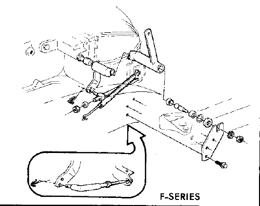

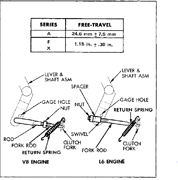

Here ya go The digital build manual is awesome. HUH?Name:  cluctreturnspring.png
[IMG]file:///C:/Users/laptop/AppData/Local/Temp/moz-screenshot.png[/IMG][IMG]file:///C:/Users/laptop/AppData/Local/Temp/moz-screenshot-1.png[/IMG]
ok i put the spring from the fork to the gage hole on the diagram i guess that's not correct. I need to go to the frame as you said.
great diagram by the way you da man!!!

So when I was doing my brake lines I noticed that the holes I hooked my return spring to were actually for the clip that holds the brake line. So I'm lost as to where it goes.
