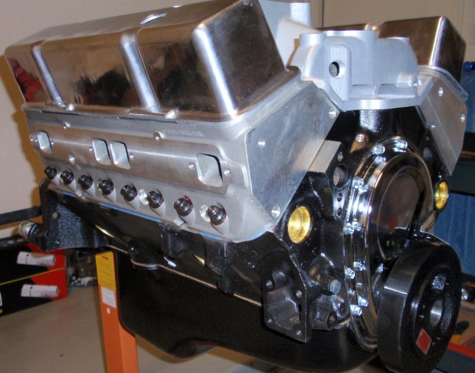

Oh NO! I did it now! Put a deposit down on the new engine that is going into the car!
500HP/525lbft Torque Small Block 400 4 bolt main monster, so much for originality...

Thats a very nice car man. I like it the way it is, but i like more power and reliability too. Those years probably wont ever be worth a lot but, that sure is a nice one.

Cool, hope you enjoy the new engine. Do what Camaro69 says about wrapping up the original engine/tranny/etc and saving for prosperity. Right before you take the engine out disconnect the fuel line and ignition coil, turn the engine over for a few seconds while shooting a oil "fogger" down it's throat. Nothing too long as you don't want to burn out the starter. That's how they do with boat engines when they're sealing them up for the winter so that way nothing rusts up or seizes for the time that it's going to sit without being turned over.
Nice find btw and good luck!
