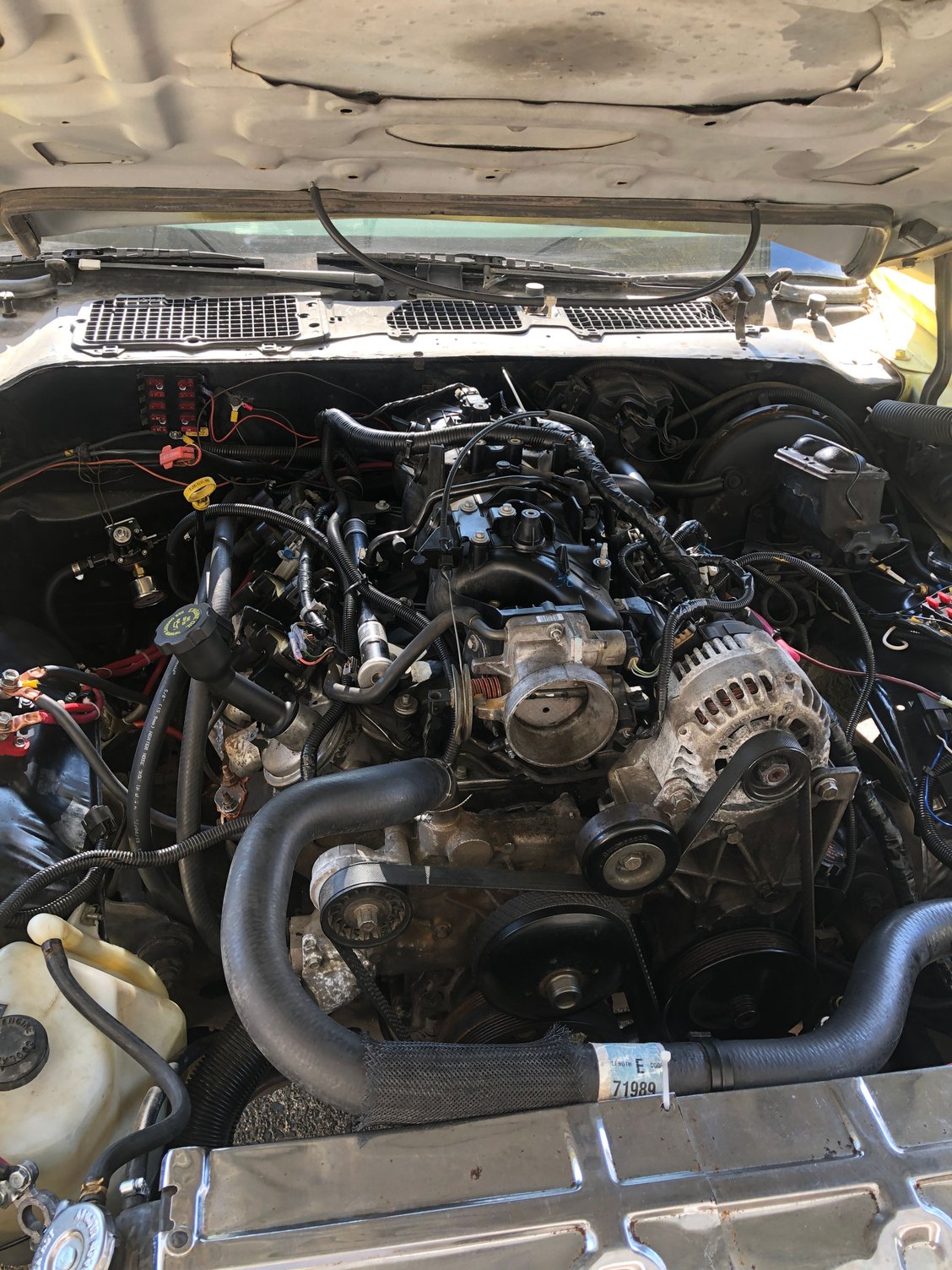

Default 79 Camaro LS Swapped Intake Manifold?
I have a 79 Camaro and I did an LS swap but the engine was from a truck so the intake manifold is tall and I can’t shut my hood. Where can I get a low profile intake manifold? It’s a 4.8L LS Vortec engine so I feel like there’s should be a good amount of intakes that would fit, I just don’t know where to look.
Old Aug 1, 2021 | 09:03 AM
I believe any cathedral port intake should work,LS1,LS6,Fast 92.
LS1 intakes are easy to come but since many like me upgraded to something better.
LS1
https://www.ebay.com/itm/16496929346...cAAOSw-qpg9r3s
LS6 flows better,this is what I swapped into my LS1 with LS6 heads.
https://www.ebay.com/itm/32472571438...0AAOSwJg5g-y~t
