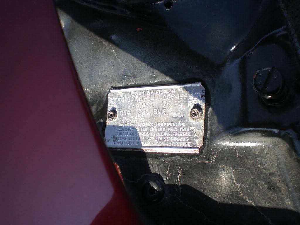

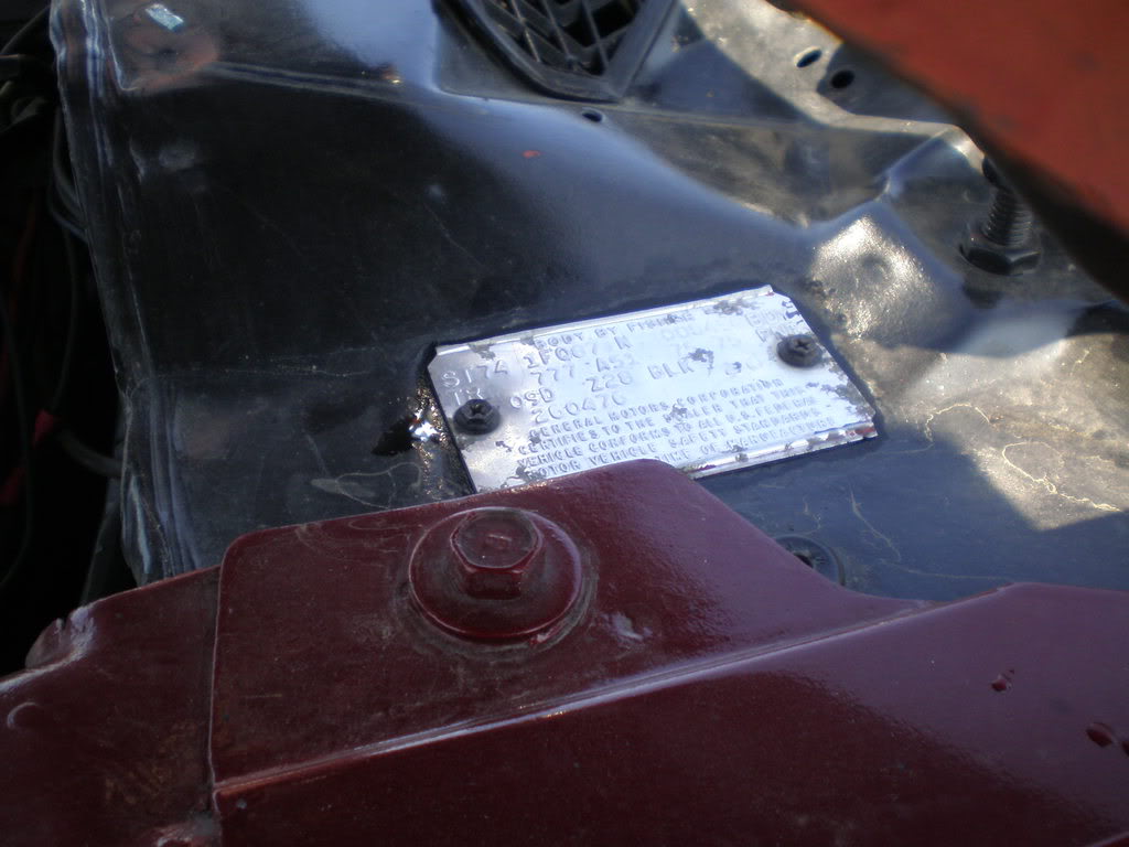

lift your hood, on the drivers side there will be another plate just on top of the firewall and to the hinges, if its a Z28 it'll say so there along with the paint code and "body by fisher" badge... same for you 74454, if your's was a Z28 it'll have that, I forgot to mention that before... Ill get a pic and show you,
Old May 26, 2008 | 01:17 PM
carguy_z28's Avatar
Joined: Mar 2008
Posts: 664
Default RE: Can anyone check these vins for me?
thats what you should see... if not then its not a Z28...
Yes, 74454, looks like yours is a RS or type LT if you dont have that...
