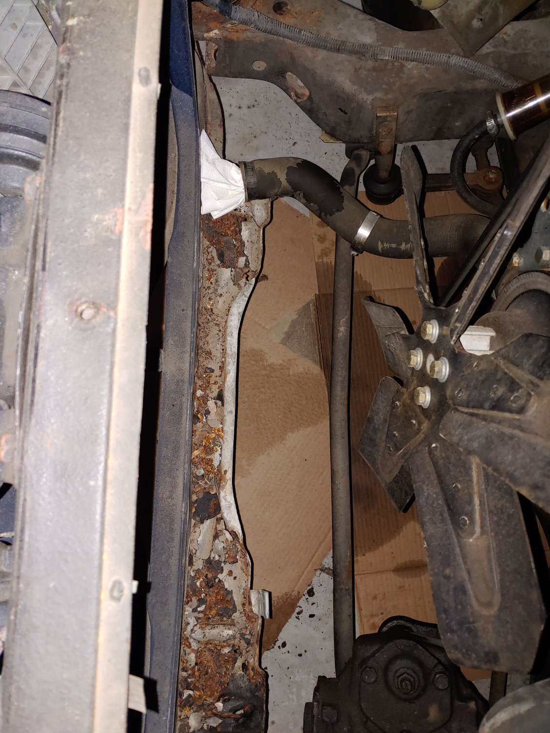

Had to stop the radiator support is all rusted on bottom.i wanted to replace but all i see is 20 1/2 inch openings?? Mine is 26 1/4 and have sent emails to a couple suppliers no answer. I like to do things right but hear bad stories on after market stuff so i think im gonna grind off rust and weld a flat piece of steel under support. My car does have heater hose on radiator 3/4 inch and other to intake 5/8 so im.going to use that center left nipple and put 1/2 to 3/4 adapter prob.i found a place to put elec fan sensor into intake beside upper rad hose on engine.
Rad support bottom rusted

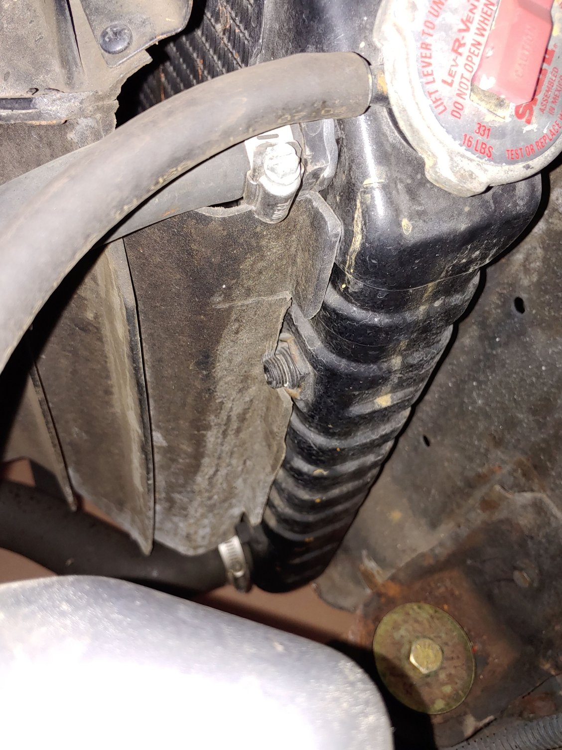

Texas70z28's Avatar
Joined: Sep 2010
Posts: 98
Default Old rad
Old rad heater hose 3/4
Old rad

Haven't seen that plumbing arrangement before on a 70 Camaro. Shroud appears to have been modded. maybe added later? Do you know the history of the car? FWIW a buddy who ran a radiator shop for years says it should circulate fine.

Got it from origianl owners nephew think its gonna work fine but the support is rusted pretty bad cant seem to find one that is 26 1/4 wide? Its factory so it seems there would be a replacement made by someone. I wanna drive it so i may have to patch it up so i can sit radiator in there.
