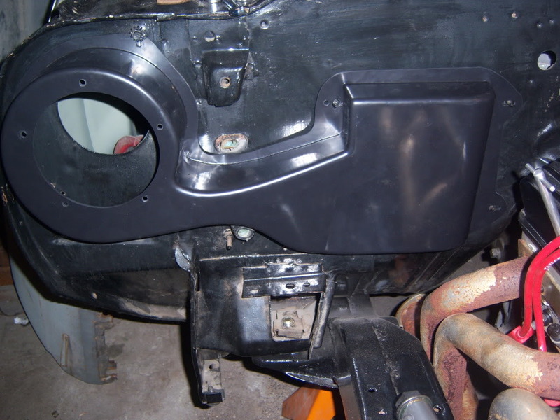

Here is my delete box. Notice the where the heater lines come out? (mine are broke) The ones on a non AC car come out more toward the headers.Name:  056.jpg

i bought the heater core for with ac. i can just put longer hoses on it right?
Old Feb 4, 2011 | 07:53 AM
  #20
If you're going to install the ac delete box like Damon did, then you need the core that you bought. It's the correct one for a car that's been modified. The stock core wont work for a non ac car.
This is my non ac car. You can see where the hoses come out behind the valve cover:
