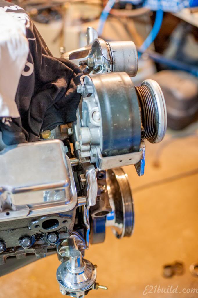

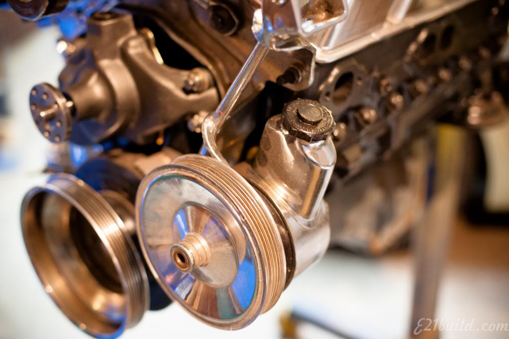

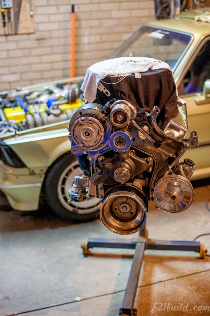

I'm in Australia (the car is a converted RHD car too) so I can't easily just duck down to a wrecking yard and pick up the parts I need.... I've not got the original bracketry, just the abortion in the pictures:

Any idea as to what the serpentine setup is? Is it just cheap eBay junk or something half decent and worth working with?
Old Mar 14, 2014 | 11:45 AM
Your assembly is very similar to what the factory setup was like on my old 3rd gen Camaro.

I guess my question then is should I persist with this serpentine setup (and get the correct water pump) or am I better off getting brackets and standard style accessories to mount to the motor, and along the way working with the water pump I already got?
Old Mar 17, 2014 | 07:44 AM
What you have will work with the right style pump. If the looks don't bother you, then you might as well leave it be.
