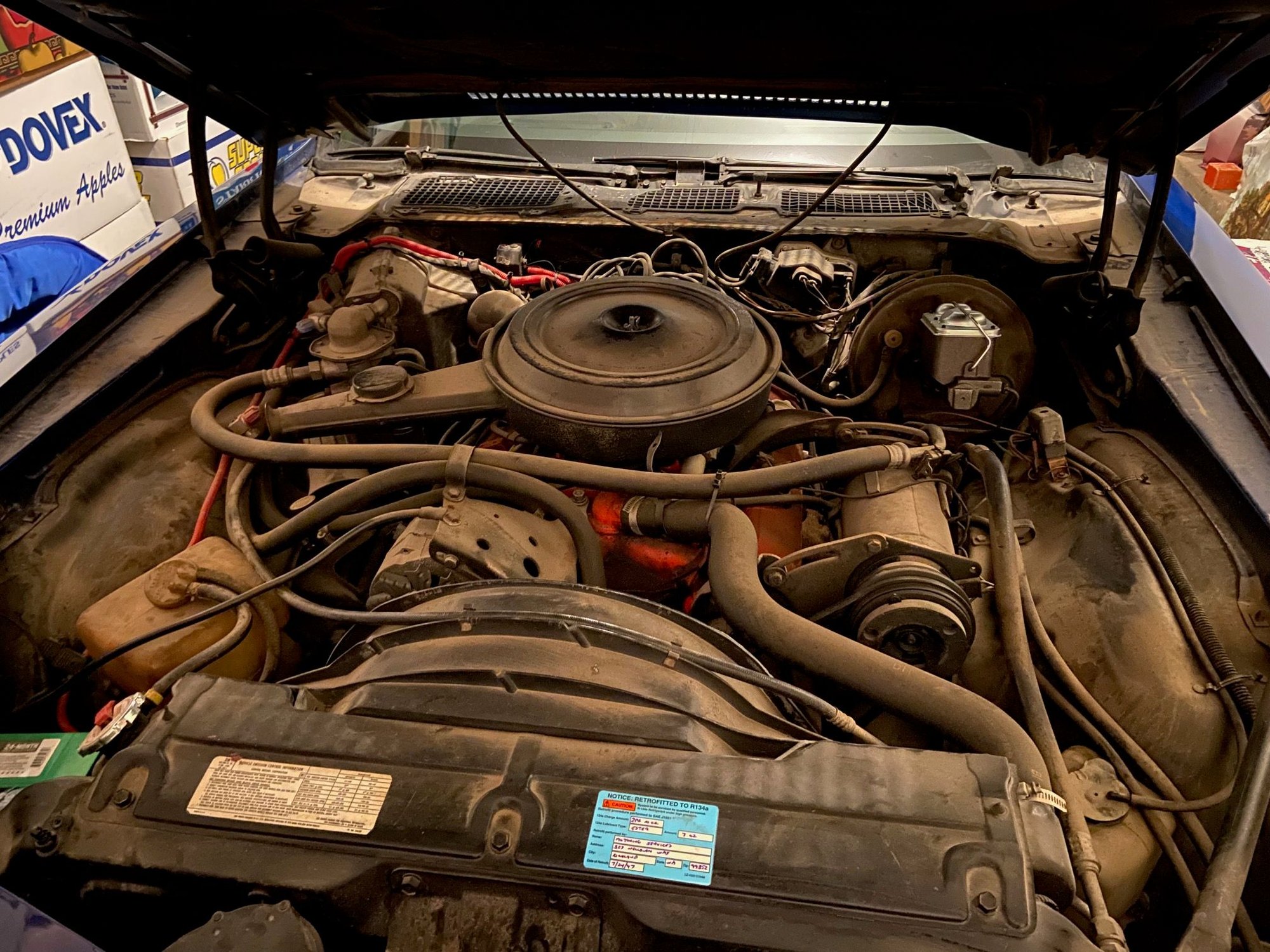

I would add that the mileage is 51k. The battery was just replaced, the brake lines were flushed, and the master cylinder was replaced. It will need replacement tires and likely need to have its heating core replaced (engine temperature spikes and fluid drains into the passenger side floor).

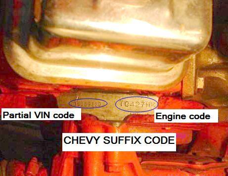

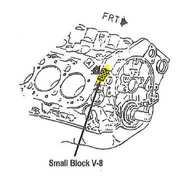

In front of the passenger side cylinder head on the top of the engine block's deck there's a pad with letters and numbers on it if the deck has not been resurfaced.
That pad will have the code to tell what the engine is and what car it was original to.
https://www.nastyz28.com/chevy-engin...-stampings.php

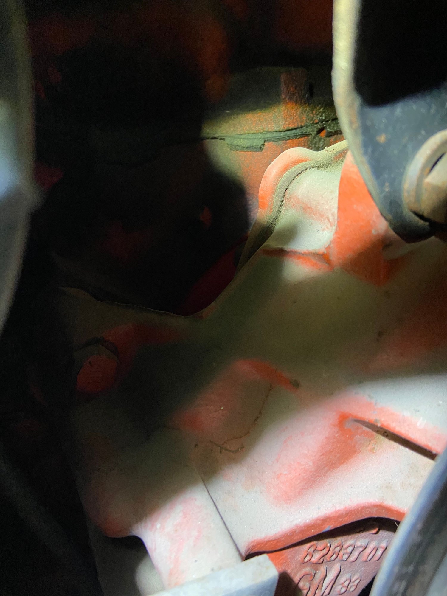

I feel like I've looked everywhere possible on the engine block for some sort of numbers or identifier without much luck. I don't see the engine pad as you described or in the link you provided. The only identification I see is what I provided in that last picture "A 8288707 GM 88" (I think it reads). Any other possibilities you can think of?

It would be right behind your alternator just in front of the cylinder head where it mates to the engine block on the same surface as the head gasket but in front of the head.
It may be that it needs to be cleaned off to see it,if you find that little pad spray some carb cleaner on it and clean it off until you can see the stamping.
If it's just bare metal with no numbers the block to head surface has been resurfaced at some point,that would be unlikely if the car actually gas only 51K miles on it.

It's likely obscured by your alternator.
This is what you need to find to ID what the motor is for sure and to tell if it's original to the car which is important for the value if it indeed is the original engine.

I think I found the appropriate information. It was smaller than I thought it would be and indeed obscured by the alternator and a dust film. After some scrubbing, I was able to uncover the following: V0418TYZ / C7J159023. Using some decoder info online, I translated this to:
  • Flint factory, April 18, 1975 350 conv.cab L LS9 165hp 4 barrel carb C-10 to 2500
  • Chevy Truck 1987, 305 cubic inch 165 hp 4 barrel carb auto transmission camaro
The two numbers seem to contradict themselves on year and displacement, any thoughts on that? Either way, it doesn't seem as though this is the original motor (159023 doesn't match the vehicle VIN either).

Well you could disconnect the supply line hose to the heater core and take off the return line then hook the supply line hose back to where the return line connects bypassing the heater core completely and making it possible to drive the car without losing any coolant and overheating.
