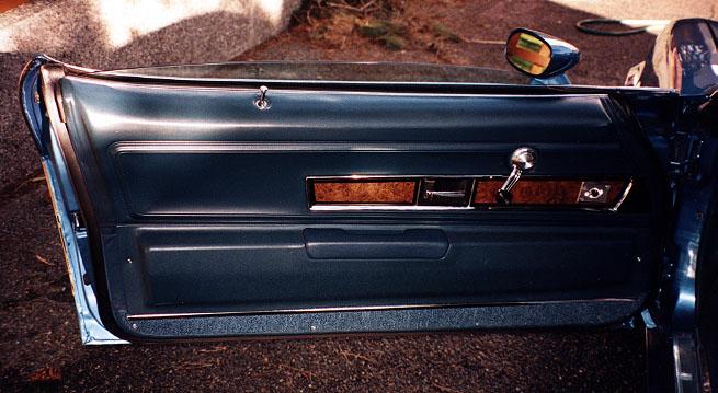

The 70-71 Deluxe panels have a longer window crank shaft. If your panels look like this, their deluxe.

Are your door panels one piece or 2 piece...can't really tell from the pic. Mine don't have the woodrain or what appears to be trim molding, however, they are similar from the woodgrain trim down. So, if I have the standard interior these should work fine...but they don't.

I have deluxe which are one piece. So you have standard and the crank shaft is too short? Is the a 1" plastic spacer on the panels at the crank hole?

No, I don't have the spacer...just test fitting everything and ran into this problem. Are you sure the deluxe interior takes the longer stems...it seems to me that the standard interior would require the longer stems due to the 2 piece design and the upper plastic pieces.
