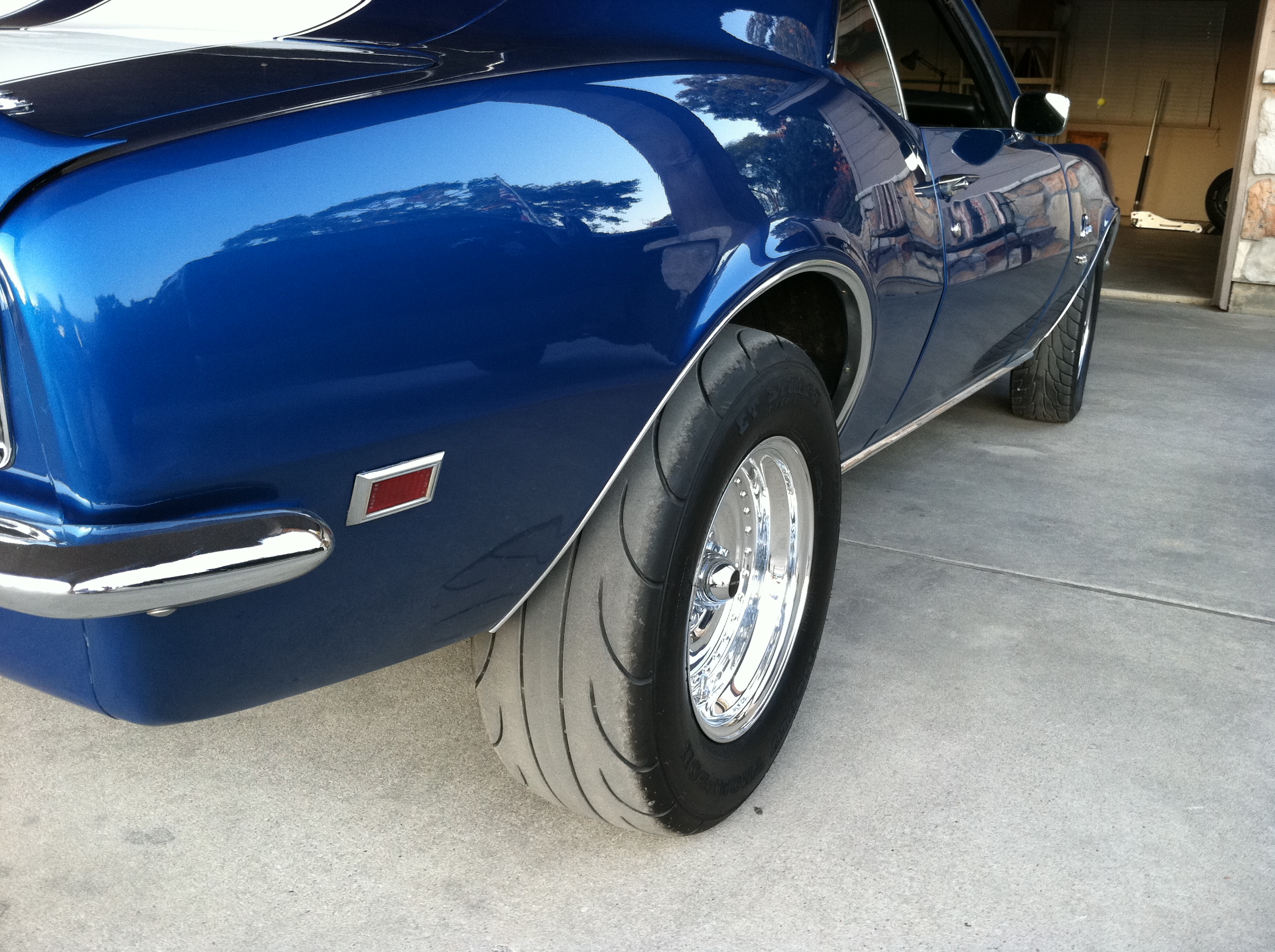

That is a very nice car.. and I like the stance. mine is lower as well with the front end down about 2" with tubular upper and lowers and adjustable coil overs.... see attached pic with the 255/60/R15's
Attached Thumbnails Will N50's fit without rubbing 68 Camaro?-camaro-profiles-new-wheels2.jpg   Will N50's fit without rubbing 68 Camaro?-camaro-rear-wheel-photo.jpg

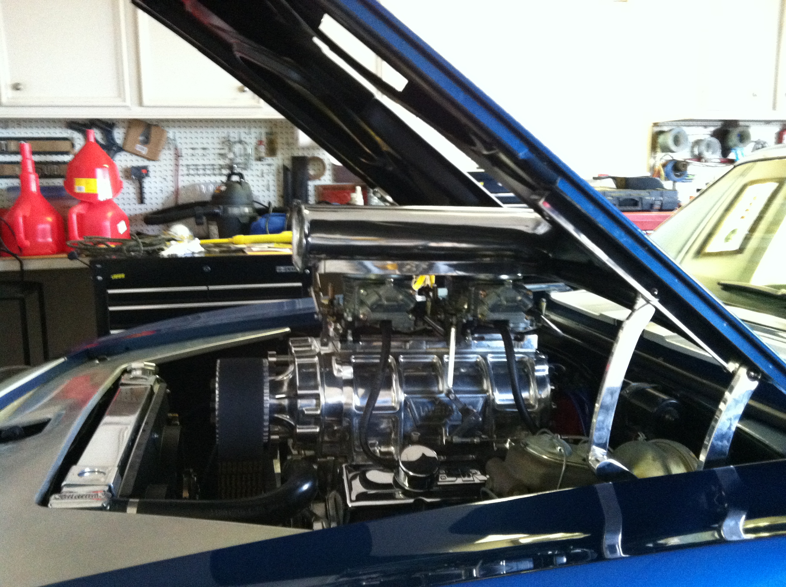

I know this is a bit off topic, but since you highlighted the blower car, I have attaché another pic of my car..
Attached Thumbnails Will N50's fit without rubbing 68 Camaro?-jan-14-2013-022.jpg
