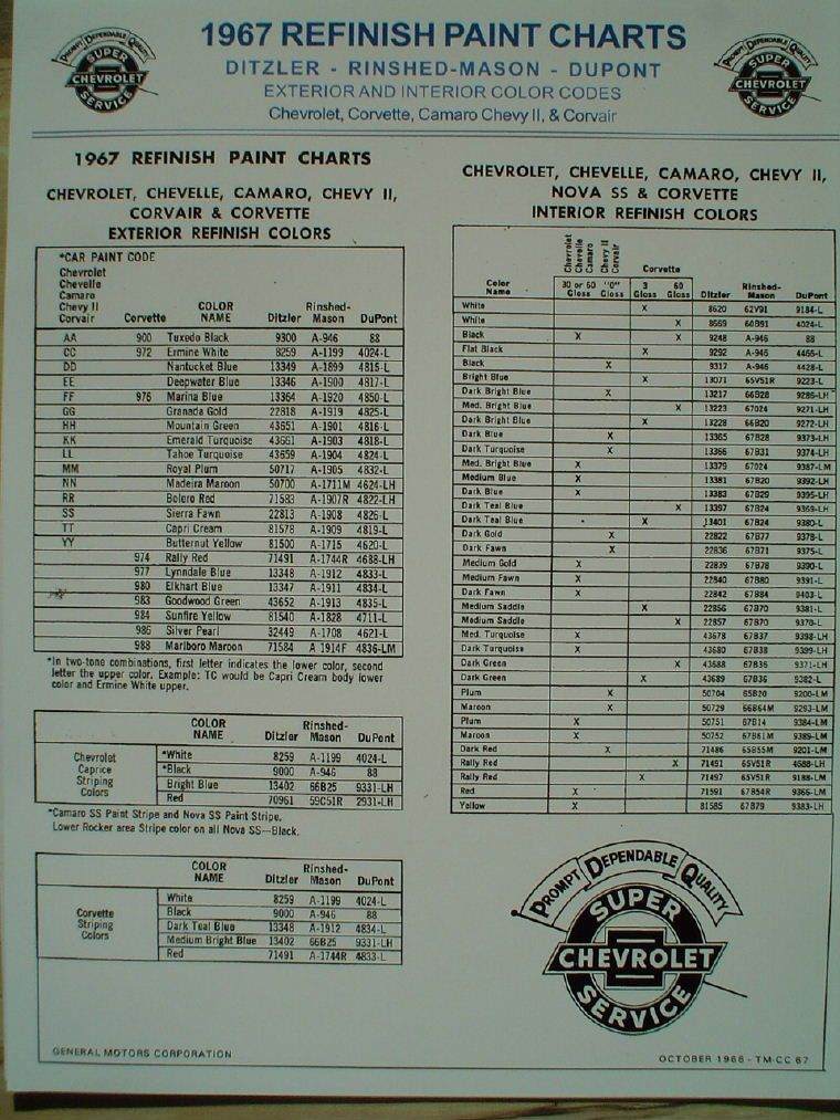

Anyone have the paint code for 1967 Marina Blue? Also need one for the white stripes. I plan on using Valspar base coat with House of Colors clear.
Anyone have this? Getting harder for paint shops to find these.

I found this chart on the Camaro Pace Cars website years ago. It also gives the paint codes for the stripes under the exterior paint colors

That's perfect. Do you happen to have a better copy that you could email me? I can see the Marina Blue code, but the interior code that I need is hard to make out.

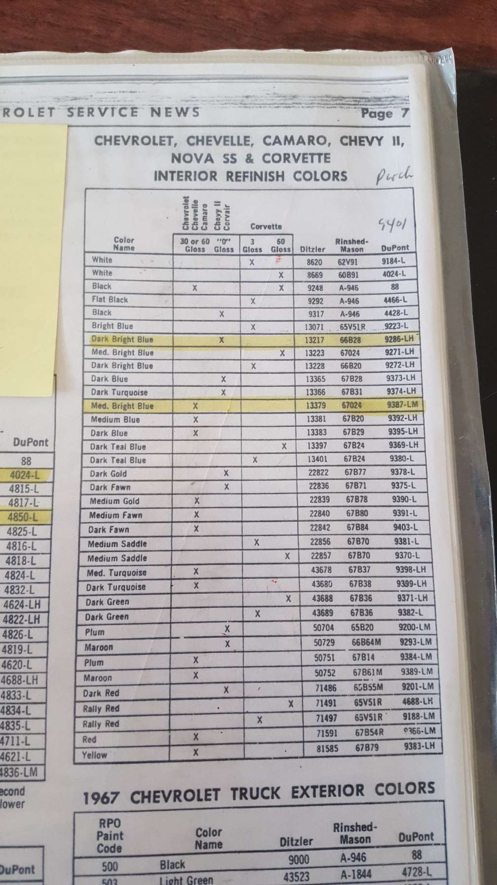

Sorry, I only have that picture of the chart. I do have another picture of the interior codes that may be clearer. It's a different paint chart than the other, but it appears to have the same interior paint code on it.

I think this is the source of the second picture. It's a copy of a Chevrolet Service News Bulletin from 1967 for sale on Ebay.

Great info. Thanks for all your help. FYI I did find out that 66 Marina Blue is very different than 67. My paint guy almost messed that up.
