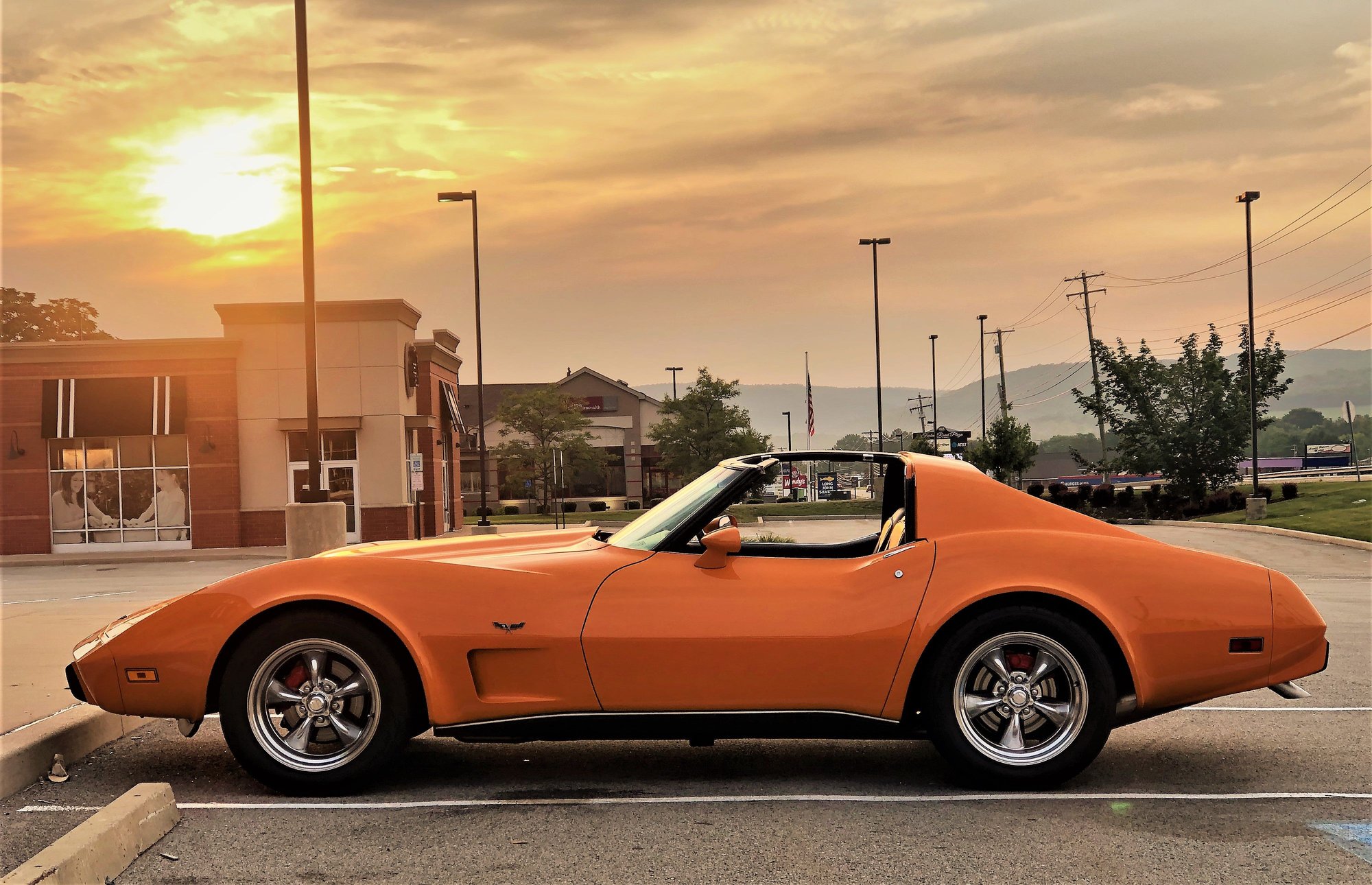

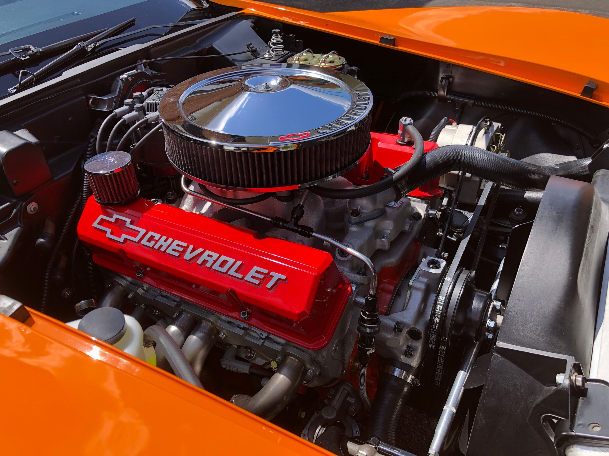

whatever you go with post up some pictures. we want to see your toy....
