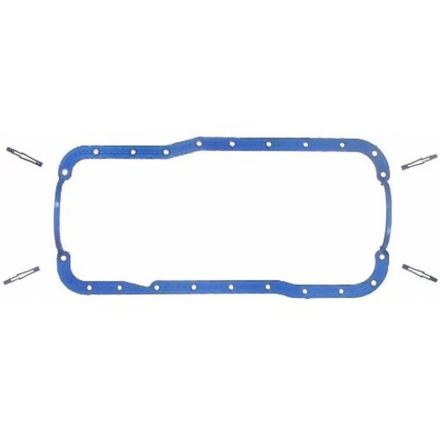

Every time I try and look up an oil pan that will fit in a 69, it shows a gasket with roughly 22 holes:
FEL-PRO OS 34508 R Oil Pan Gasket Set

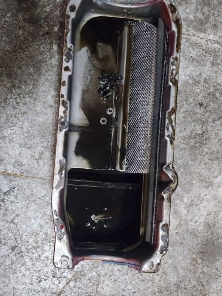

THIS, however, is the oil pan that came off the engine:
Oil pan that came off the stroker
First, I need an actual pan that will support this swap and second, I need an oil pan gasket that will work with it,
Do I use this gasket and just ignore the extra holes? Do I get a regular oil pan for a stock 350 69 Camaro?

The problem is the only small block pans I can find have like 20 holes on them and this block only has 10 (5 on each side)
Do I just get a small block pan for a 350 (and gasket) and ignore the extra holes in the pan and the gasket and RTV the whole thing?

The lowest picture in my op is the oil pan I took off, IT only has 10 holes. The gasket that was on there is still on, so if it's got more holes, they are covered, but the gasket on there has no additional holes. I'll take pics tomorrow.
