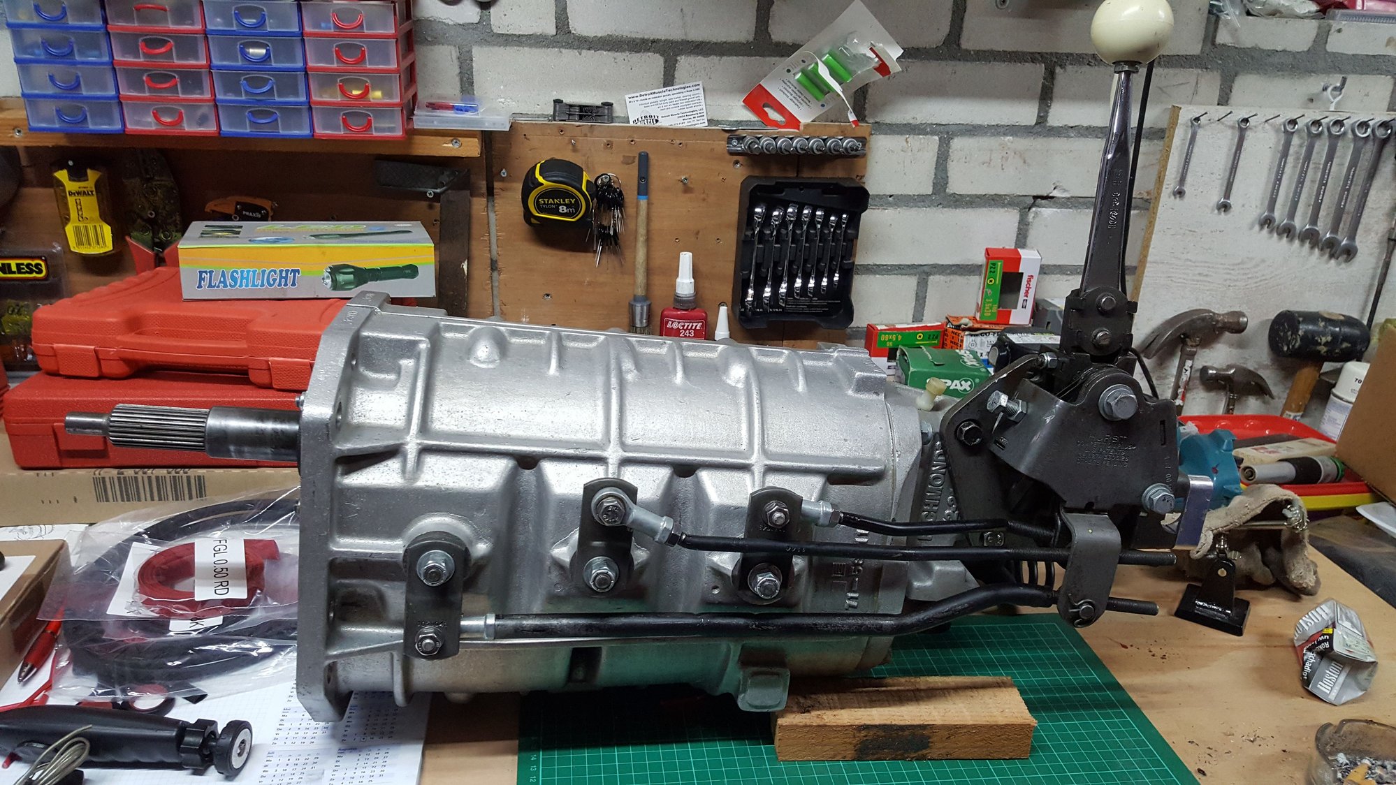

Hello All,
I have a richmond 4+1 speed for my 68 camaro
What is the best fitting bellhousing for this transmission
Here some pics of the trans.

Here the trans

'621' last three numbers on the casting, A Quick Time BH and do nothing to it as it is SFI approved.
Ask Jody at Jody's transmission for advice and may be buy one from him.
Use a sial indicator to center the BH onto flywheel for less chatter.
