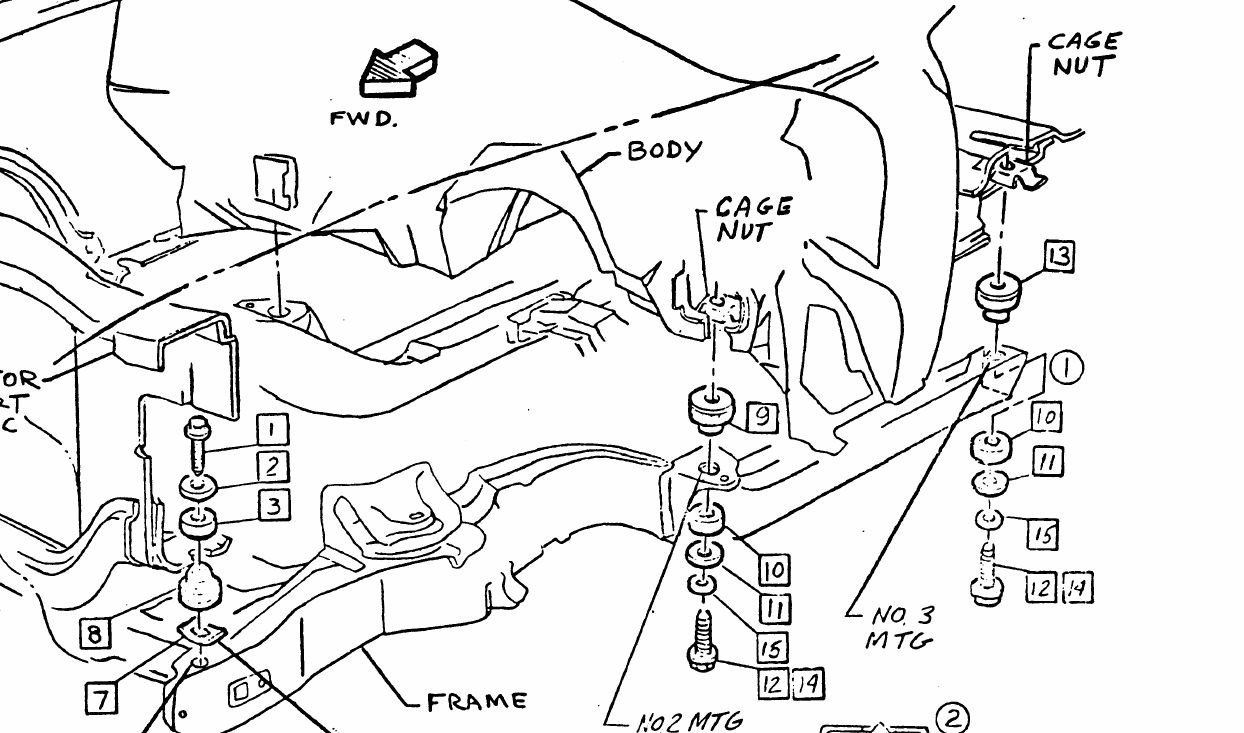

My next decision will be the body mounts. The ones presently are in dire need of replacing. I managed to get a hold of some solid Moroso ones but they seem a bit thinner than OEM. If I try
to install the solids with the front sheet metal intact is it going to throw off the body alignment? I had used the same mounts on a 69 Camaro but with entire front end off.
Has anyone here tried to install solid mounts with entire front intact and not deal with realigning the fenders, etc??

I would like to learn too if just replacing all body mounts can affect alignment.
As I see it, the subframe is bolted in 6 places. Is there any adjustment? Or if I remove the subframe and bolt it back where it was, is that going to work?

technically, the subframe is bolted in 4 places to the body. The other 2 mounting points are used to mount the radiator support/ inner fenders, etc. the 2nd mounting point,
(see diagram) has a hole next to the body mount hole that is used to insert an alignment rod that goes into the body. You can use a thick bolt also.
