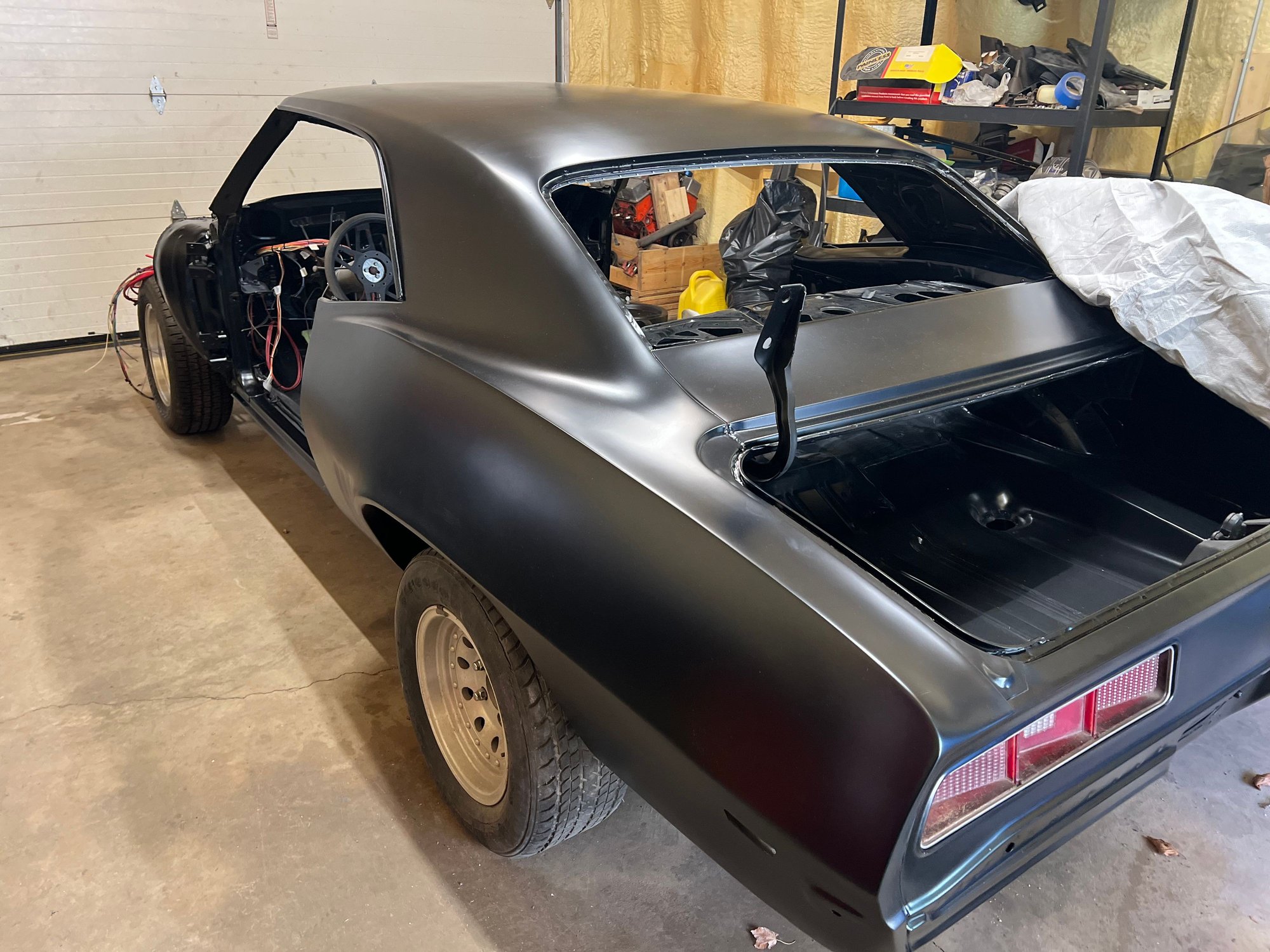

I have a 69 camaro , front suspension has a coil spring with a shock in the center, should i just replace the shock or switch to a coil over? Second question, rear suspension, it has a single leaf , whats the best shock for that ? Any help / advice would be greatly appreciated

My bad , car is getting 100%restoration , no rust at all , just painted, as far as what i want is just a nice ride , not gonna race it , just go to car shows with it , im just looking for a nice smooth ride, and as far as budget , i don’t really have one lol
