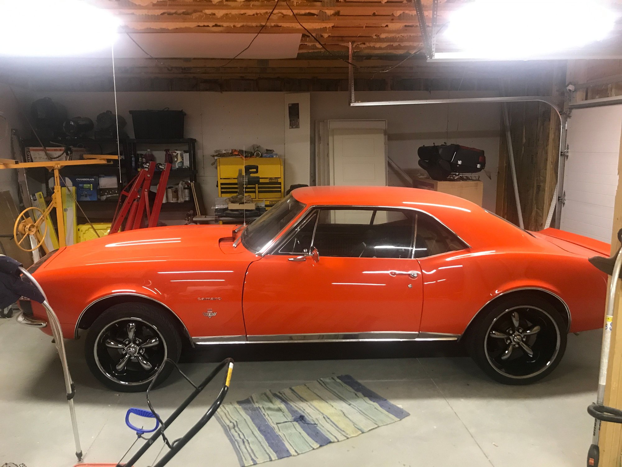

I put new oem coil spring in my 67 Camaro now front end sits high.
rear has new multi leaf springs. Any suggestions to bring rear end up. Or from down a little

Not fun, but, remove springs and have a spring shop put them into a press and compress them to coil bind.
This action stress relieves the spring(s). Or install six cyllinder springs.
Old Oct 21, 2019 | 07:48 PM
....Or install a big block.
I would drive it for a little while to see how the front and rear settles in.

Especially over railroad tracks, as in street crossings, for about a week?
