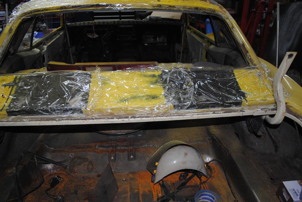

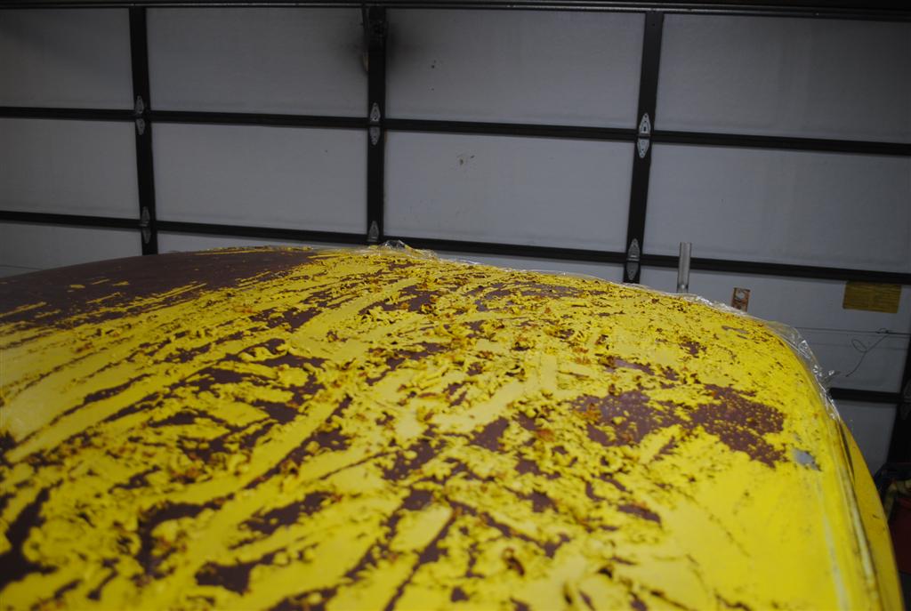

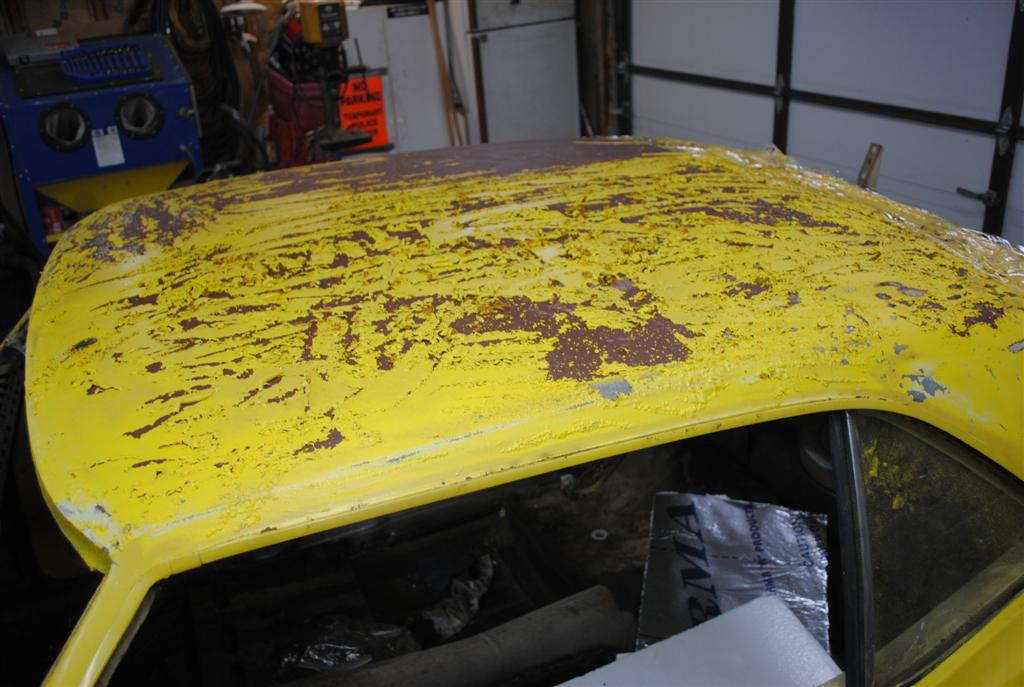

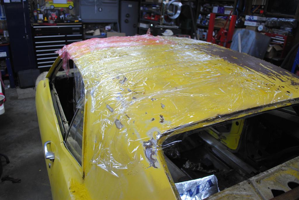

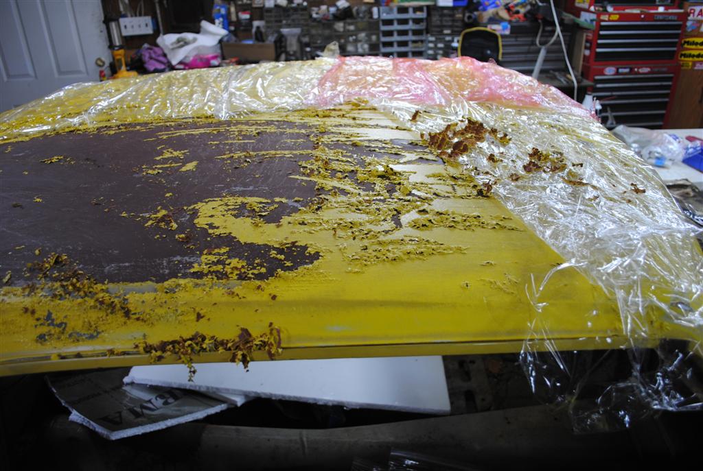

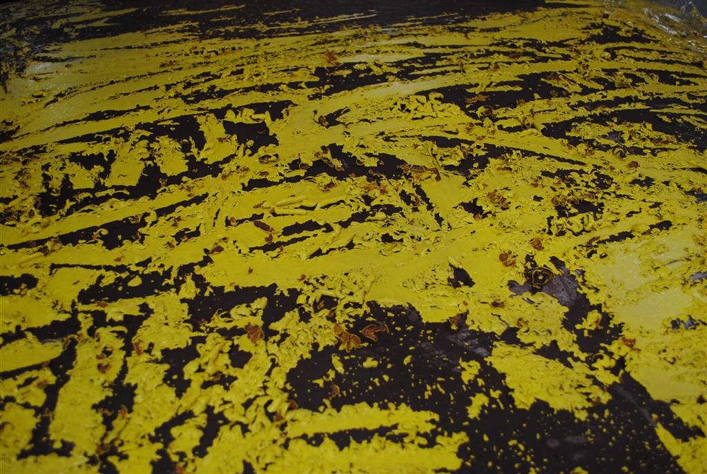

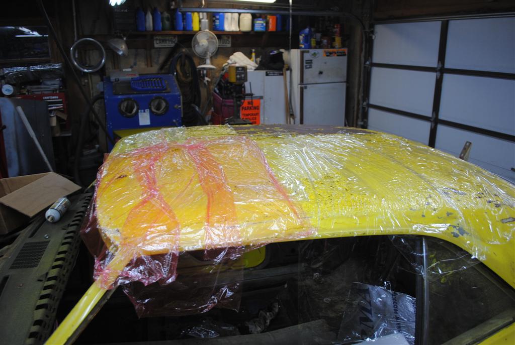

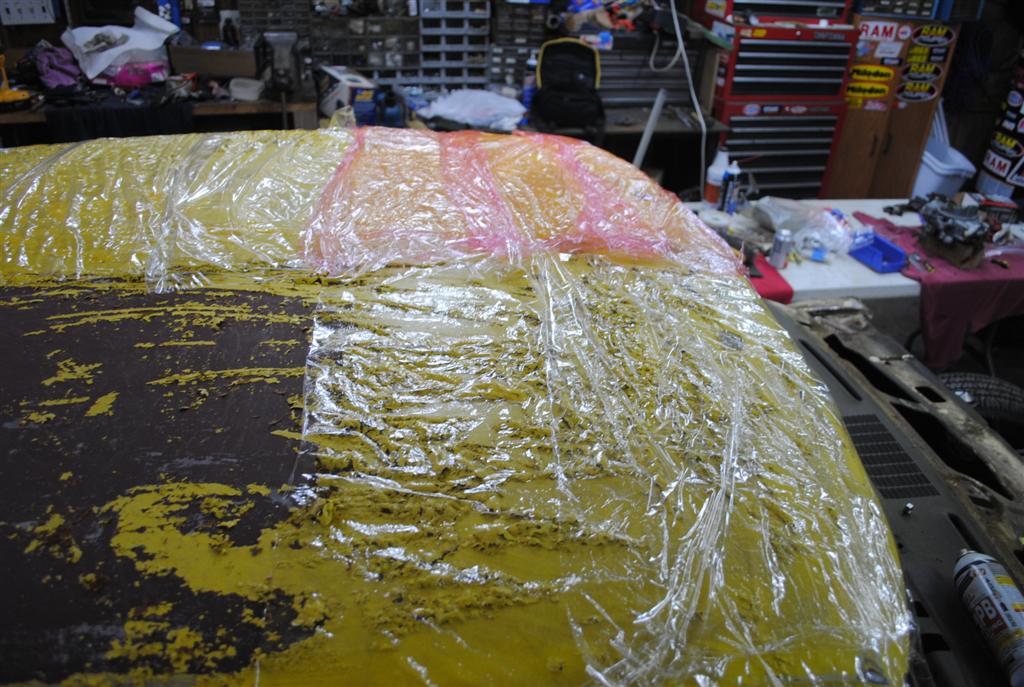

what happens when you have paint stripper and temps in the high 40's?
you get paint that doesn't remove very easily. unless you talk to the right person.
a good friend of mine gave me a tip. first, scuff the paint with a DA using 40 grit. then, lay the stripper on heavy ( HEY NOW ! ) and then cover it with plastic wrap. the fumes are held in with the chemical making it more active. and i'll be damned, it works ! check it out! you can even see the brush strokes where i put it on too thin.

My wife would have picked Purple so your lucky i guess?? ps Costco sells some really BIG rolls of the wrap BTW

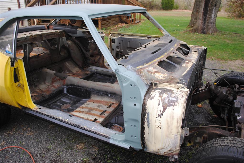

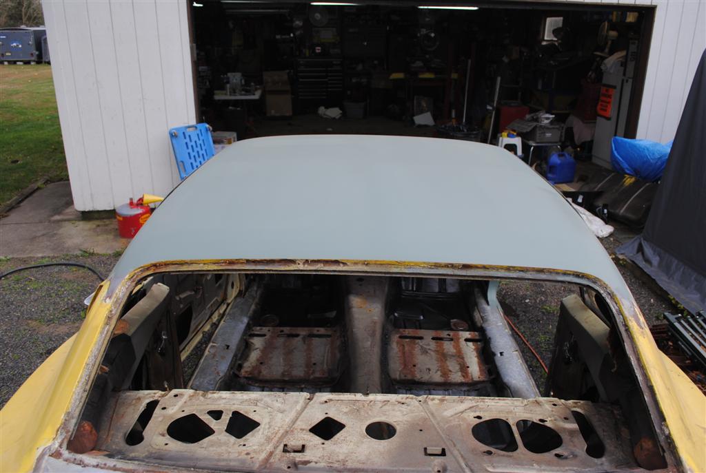

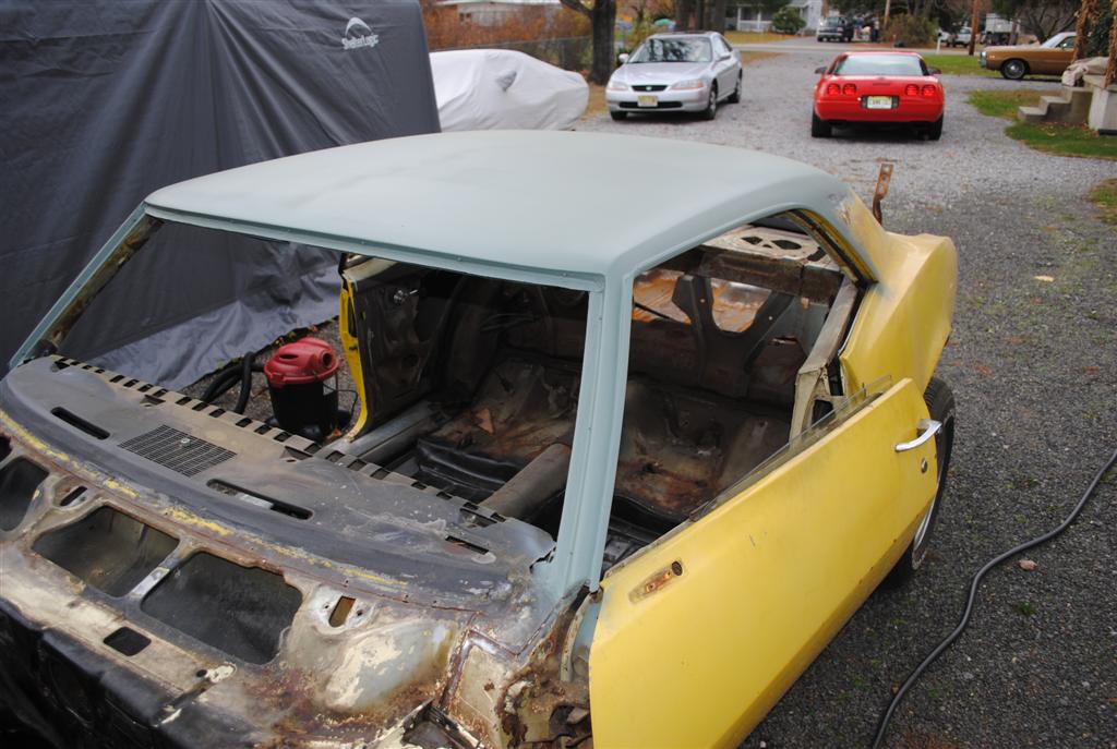

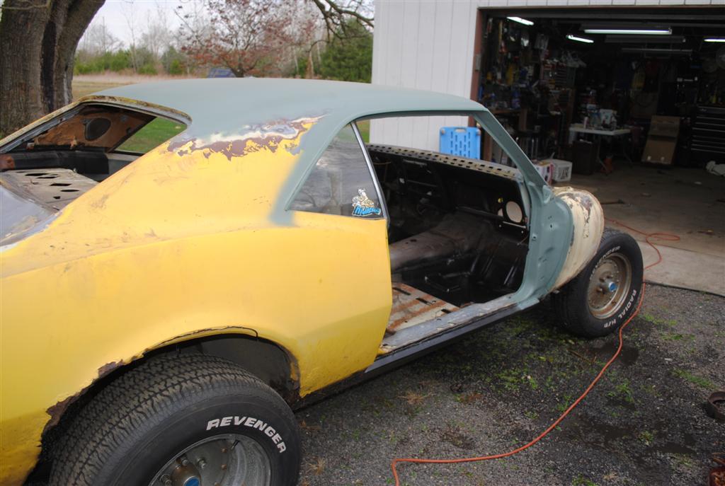

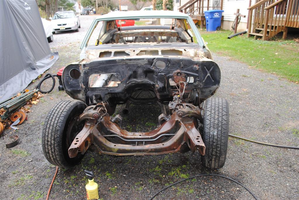

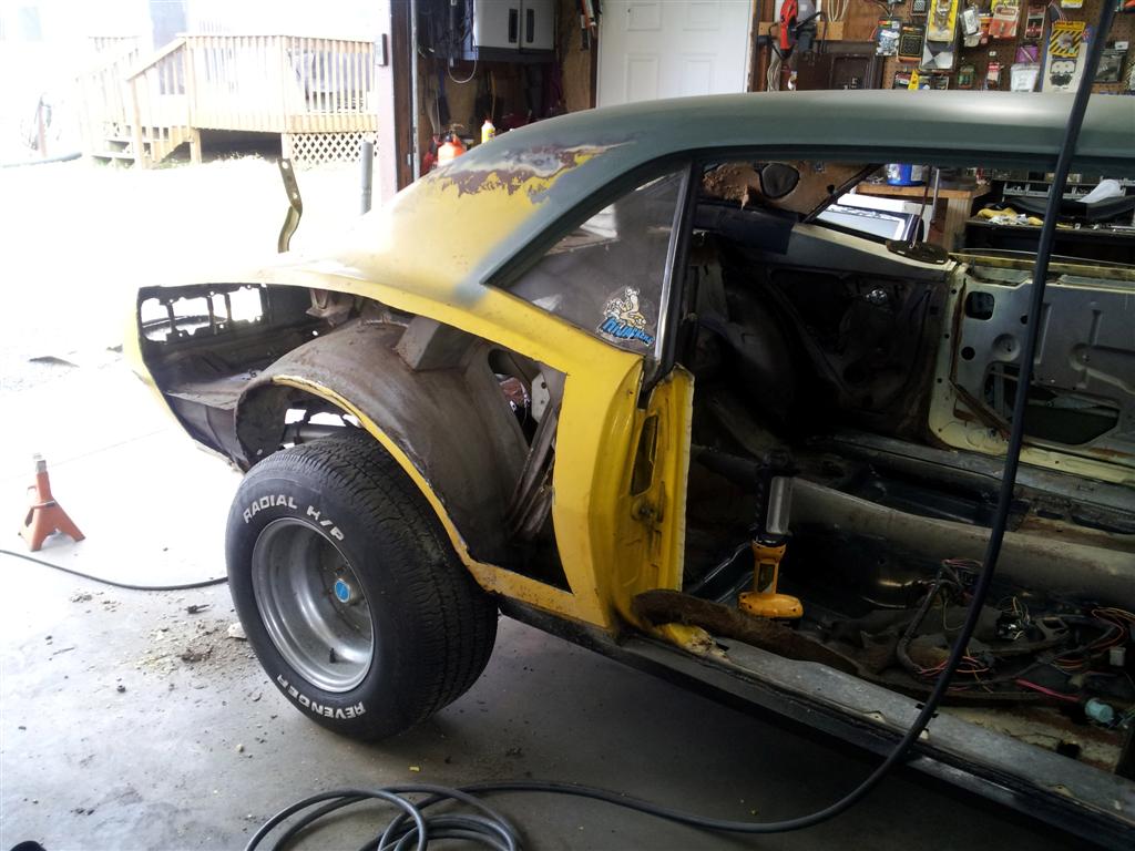

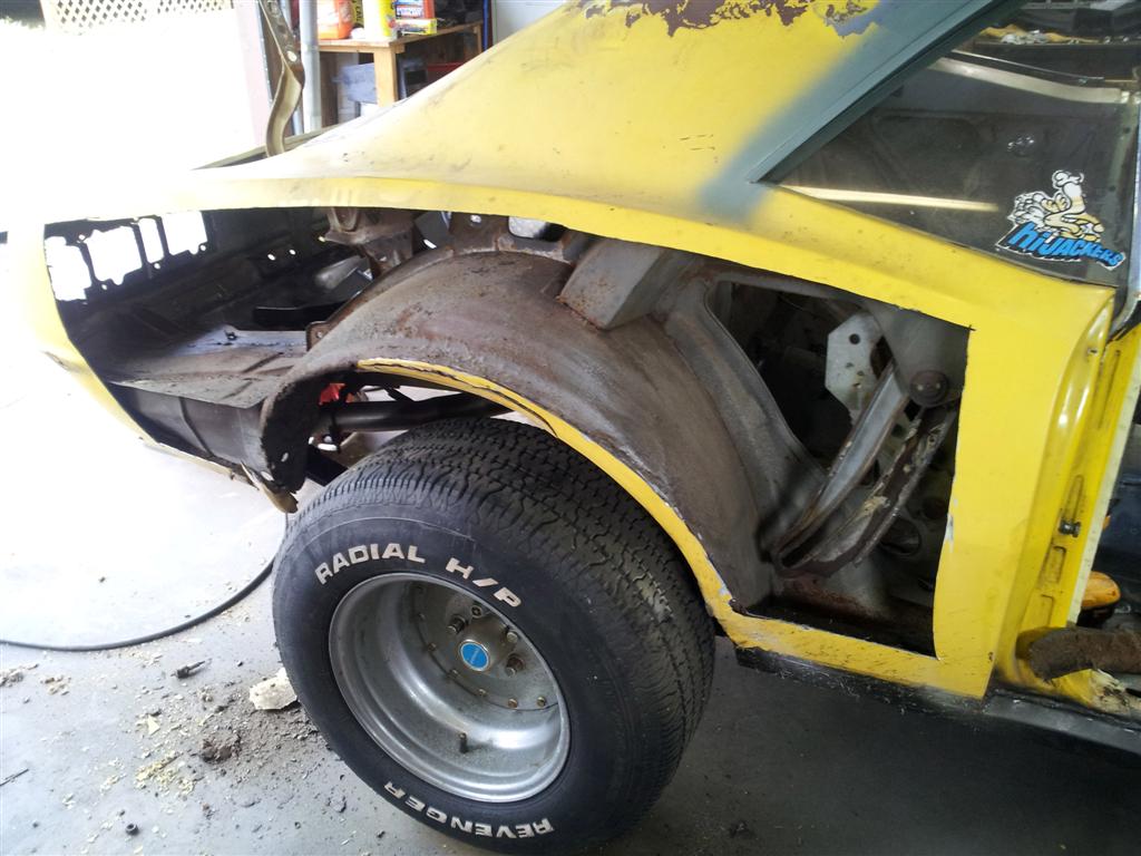

here's a couple progress shots

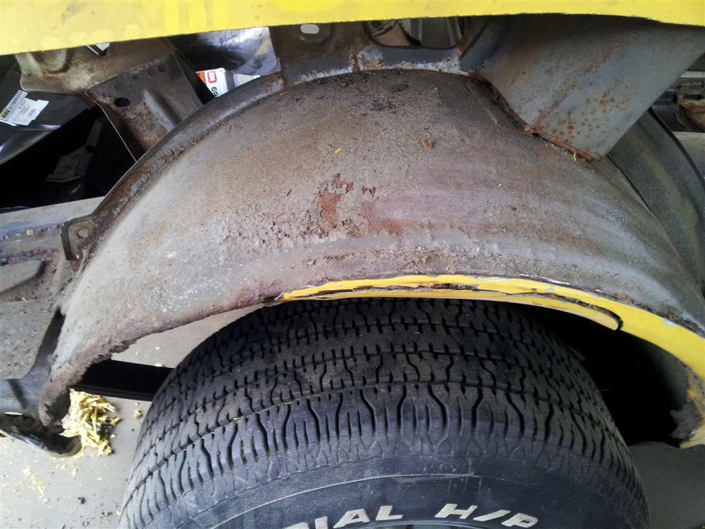

cut the QP off so i can see if i needed anything inside. ordered up the sheet metal we needed last week.
