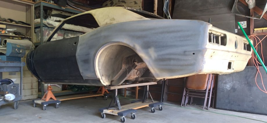

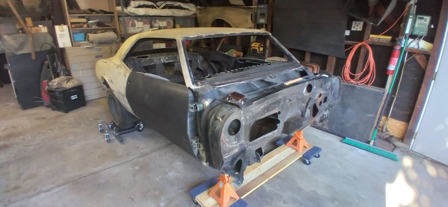

Old Apr 12, 2021 | 11:49 AM
Turbo86's Avatar
Joined: Feb 2021
Posts: 201
From: Sacramento California
updated pic
