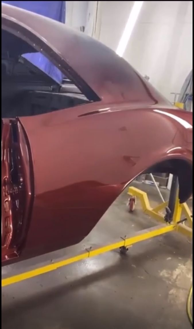

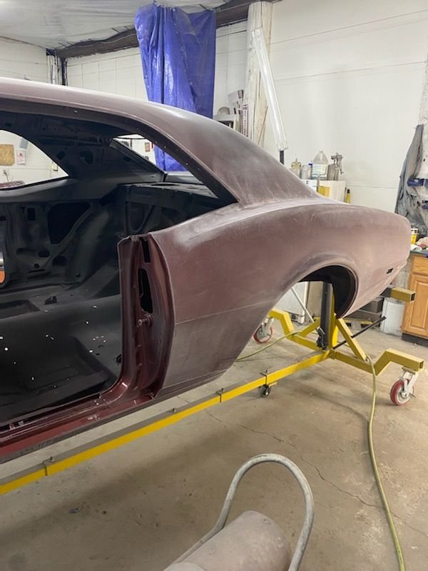

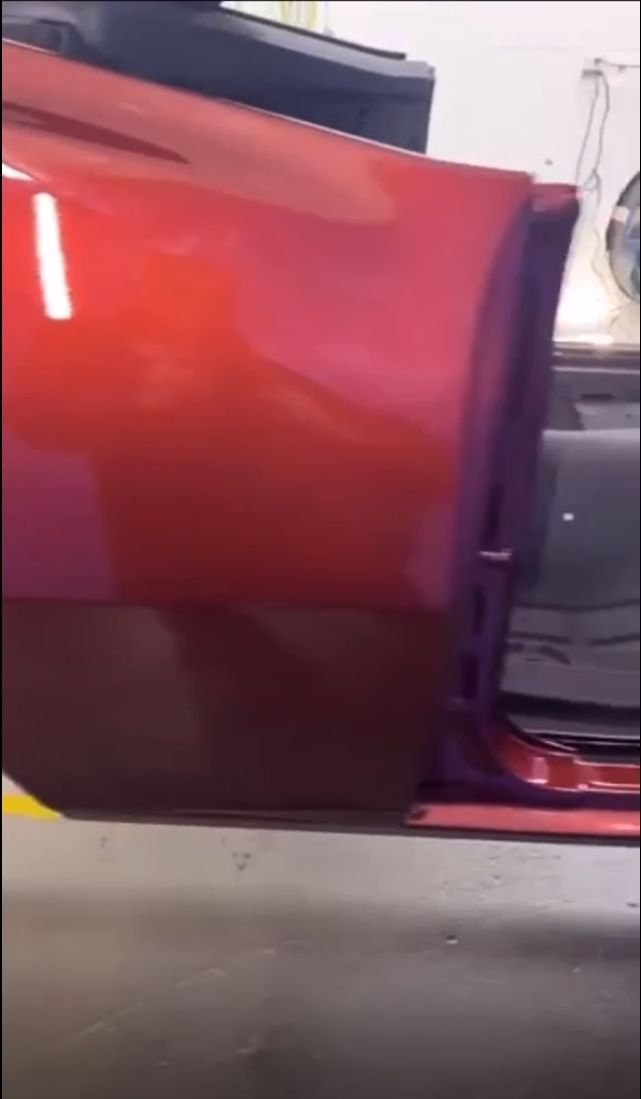

Body is fully painted now. Here are single frames from a high-def video:
Pictures aren't real hi-def as they are single frames. Disregard the variety of colors on the roof pillars, as that area will be covered by vinyl, down to the line of the fender. Color is "indoor lighting" and also influenced by blue tarp around portion of paint area. RIcky will be moving to Restoration Shop on Wednesday to FINALLY become a roller. They will take pics when he is in daylight on the parking lot between the buildings, and we can then see what Cordovan Maroon really looks like!
They are making a slight change to task list order while he is still on rotisserie, by having the headliner and vinyl roof cover installed before front and rear installation allow him to rock and roll. This will minimize risk to fresh paint both inside and out. The Morris front seat belt uppers will be put on with the head liner. I am told the paint job came out "perfect" but it won't be wet sanded and buffed until it finally returns to Body Shop.

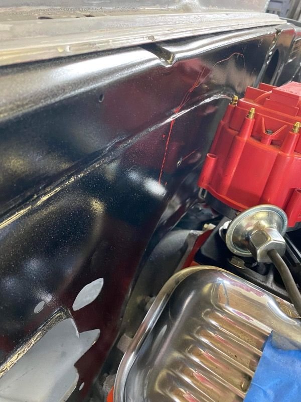

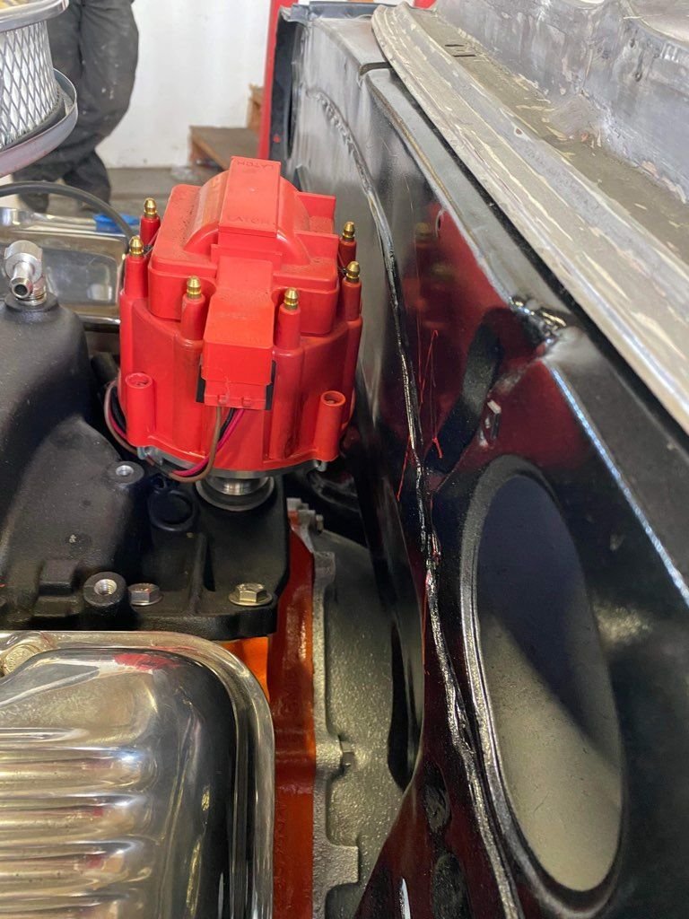

One other note of interest to Y2Keglide, concerning the dish that went into the firewall. During my recent visit, I was told that it was NOT because of clearance from distributor cap to firewall becoming less during hard acceleration. They assured me that the motor mounts used (polyurethane inners, I think, for shock isolation) have minimal give and correct geometry for big block. HOWEVER, there was not enough clearance between HEI cap and firewall to allow it to be turned for timing purposes, as the cap fasteners came up against firewall when they turned the distributor. Here is a different picture than the one I posted back when we were discussing this, plus the one I posted at the time:
So, contrary to the red line drawn on the firewall, the dish was done lower, where the fasteners stick out from the cap. Plus the dish was made deep enough to still leave adequate clearance even if proper timing left the extrusion in close contact with the firewall.

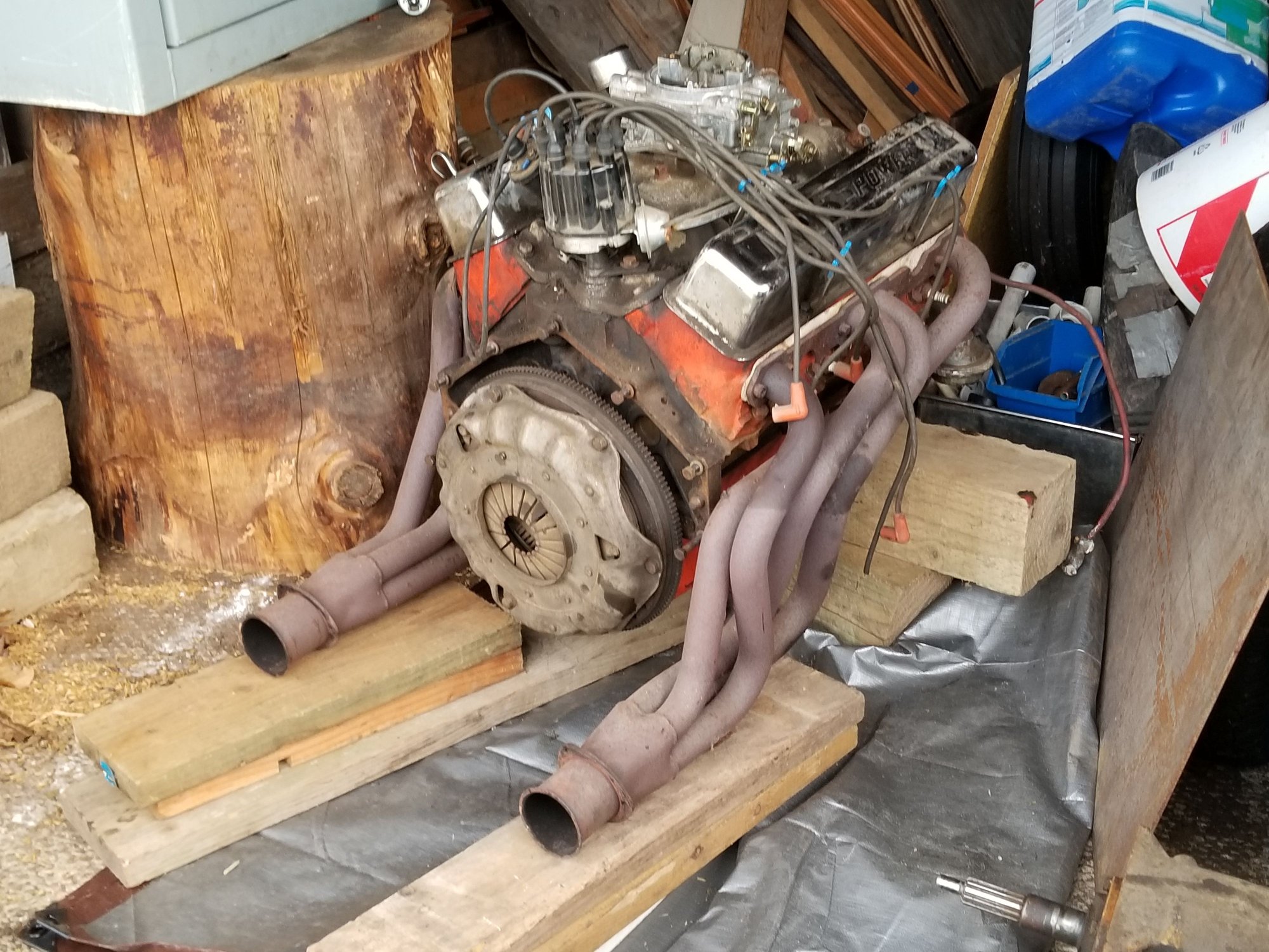

By the way, I ended up with a spare 327, complete with steel-tube headers and a spare carburetor, as well as a Saginaw 4-speed. Just wondering if anyone out there within driving distance is interested??? Looks like this:
Ran good the day they picked up Ricky to begin this voyage.
