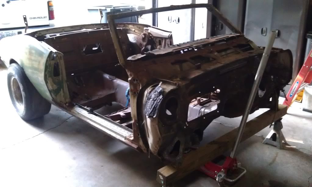

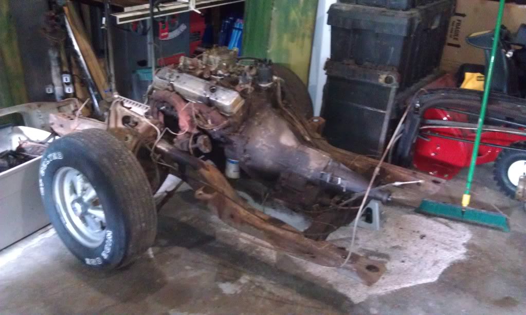

Progress! I was able to spend time on it this weekend, and tonight. The frame horns are in great shape!!

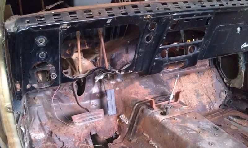

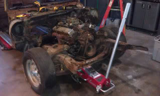

Size:  73.6 KBName:  IMAG0191.jpg
