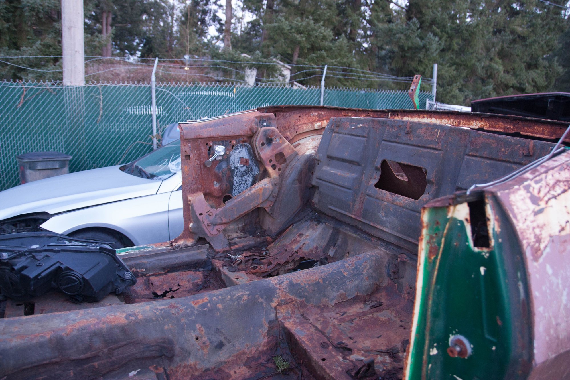

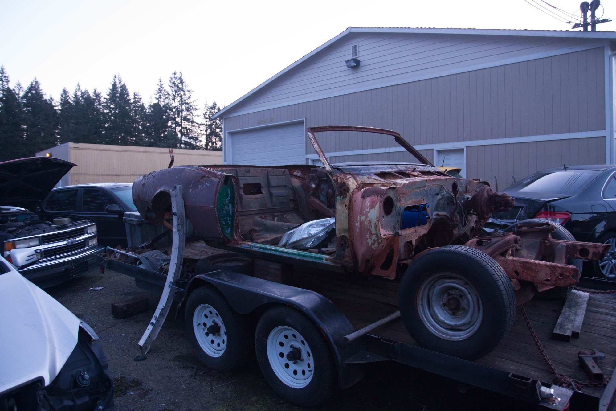

Default ok here some pic's
it has the factory disk brakes

Hate to say this, but she's not an A/C equipped.
The rectangular hole is std heater as if A/C equipped, the the firewall would have a vertical hole, say 4X12 inches, on the left side.

You should be looking at a Dynacorn body. There is a easy 20k in metal work on that car. The area where the rockers meet the cowl and where the rocker meets the rear frame rail is the most important structural area. In those pics both those areas look like a compete redo. Most pros will not mess with those areas unless the build is on a body jig. I have seen convertible bodies a lot more whole then that sent to the scrap yard.
Reality is the only way that car is worth a real restoration is if its a Copo but even then it will be cheaper to pull the tags and slap them on a Dynacorn body. If you are good with metal you could do external comedic repairs and build or buy a tubular chassis.

That small diagonal oval hole next to the heater box hole on the firewall is for the heater core tubes on a small block car.

Good eye, The big block cars had the holes in the cover close to the fan. The small block had them in the fire wall.
Starting to look like a RS/SS L48/M20 car same as mine.
