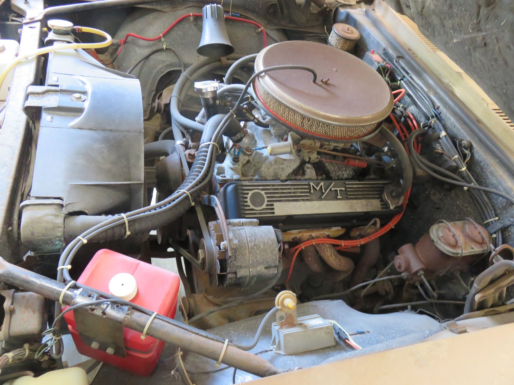

In 1973 I purchased a 1967 RS/SS Camaro Coupe from the second owner. The car was a California produced factory SS/RS with a 350, 4 speed and a ton of options like fold down rear seat, vinyl top and a host of others.
The car had been stolen out of his driveway and when the police located it the original 350, 4 speed, hood, radiator, all four rally wheels and some other items had been removed and the car dumped. He was insured but spent most of the money elsewhere and the car sat in his garage for a while on some cheap mags and tires he had bought so it could be rolled,

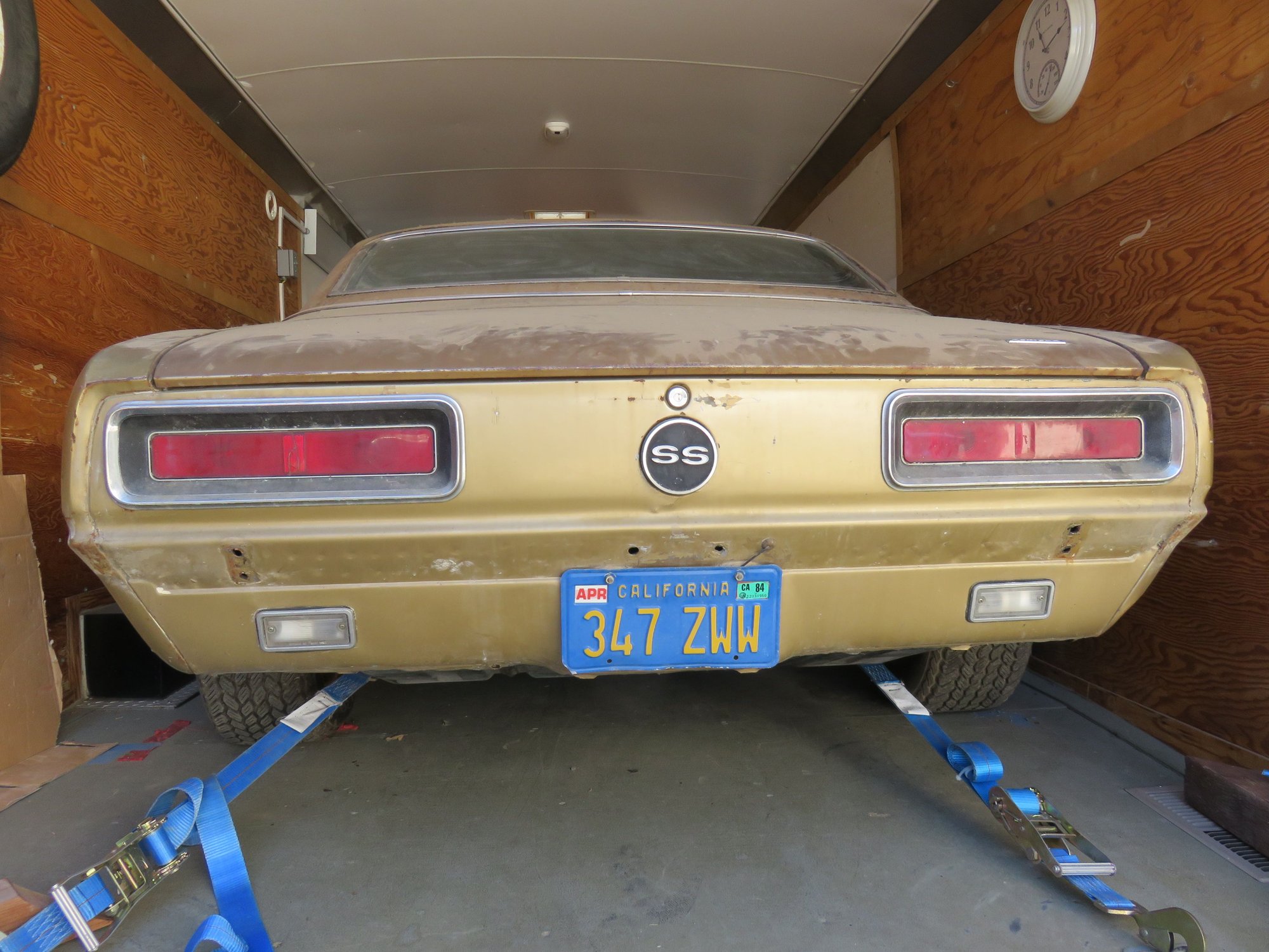

Fast forward to around 2013 and I've sold my business, I'm retired and have no warehouse to store the car so it gets sent to a mini storage unit. I get a few other projects out of the way and in early 2016 it finally "comes home" and hits my garage.

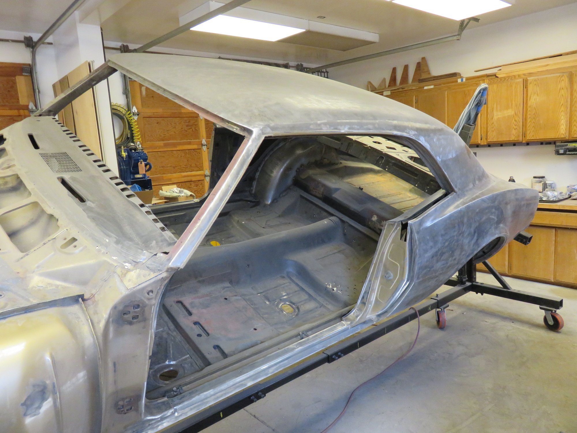

Default still way out of sequence but I never seem to .....
A couple of "older" photos as the car has actually been mechanically put together and now is back apart and up on the rotisserie again so I can media blast and then start body work.

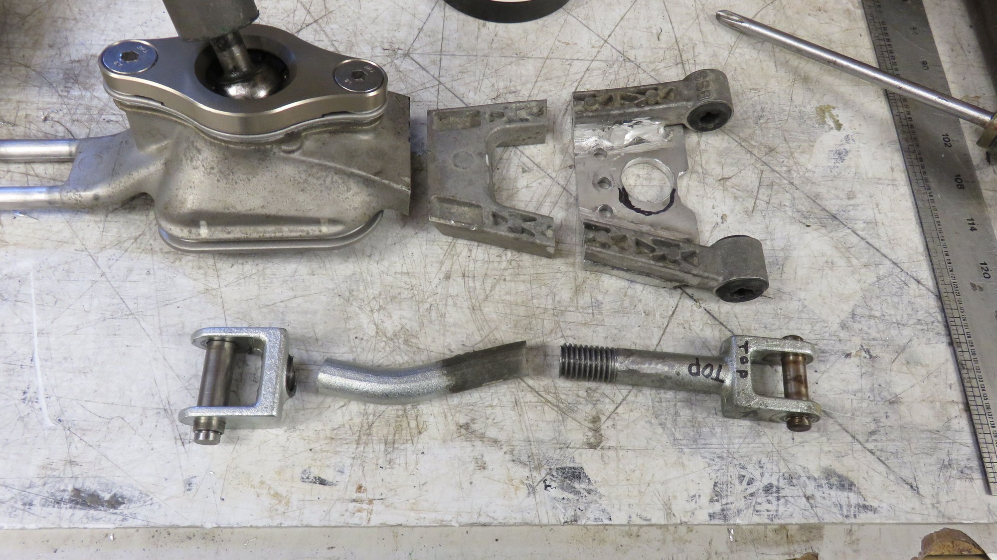

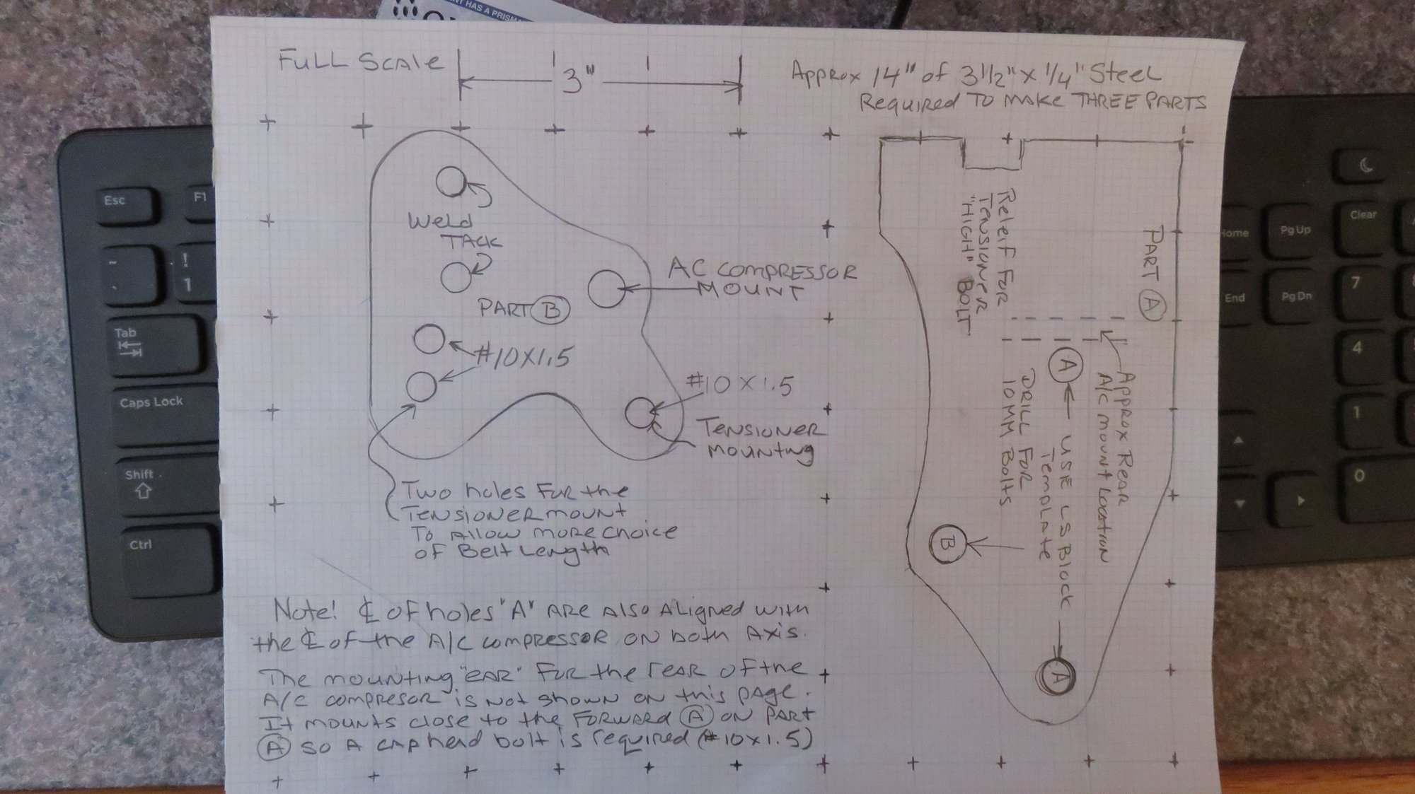

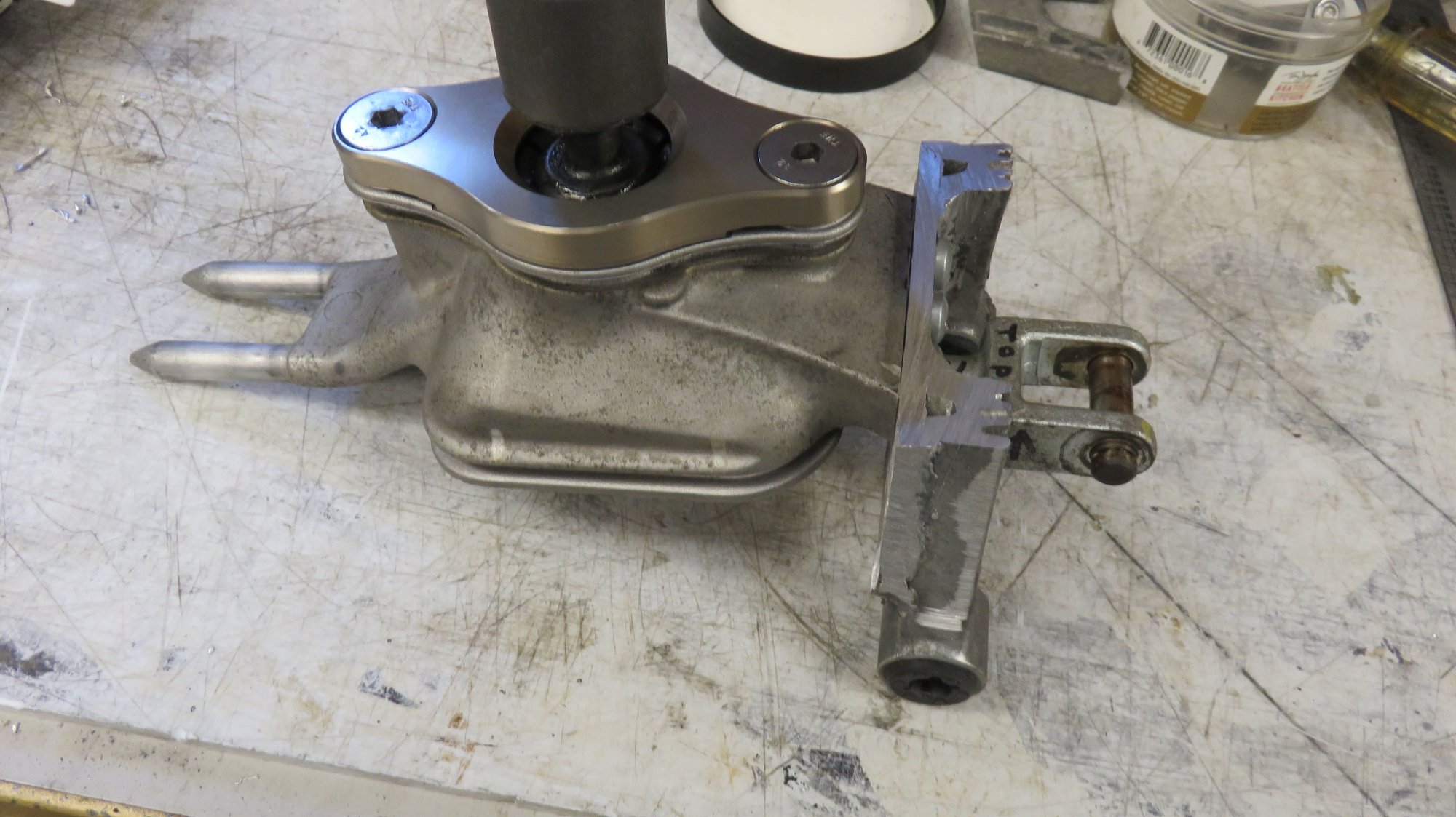

I'm not sure how these are going to load but here is what the pictures are about. The "blueprint" is for the two pieces I had to make in order to fit the Vintage Air compressor into the build. I wanted it to mount "low" and that is where the rack for the TCI front end is located so the Vintage air mount for an LS in a "stock" '67 wouldn't work. Kind of moved the compressor to where it cleared everything it had to and a belt would still line up and this was the answer. It fit up perfect. I got a 2012 Camaro shifter and set about cutting it up to move it to where it would come out of the floor in the right place to feel "right" I'll weld up the part that is temped with screws, just wanted to put it in amd both make sure it worked and that it felt like it was the right place first. Enough for today.
I'm about 40% done with media blasting the "body" and already have just about everything else blasted already. Slow going for an old man LOL.
