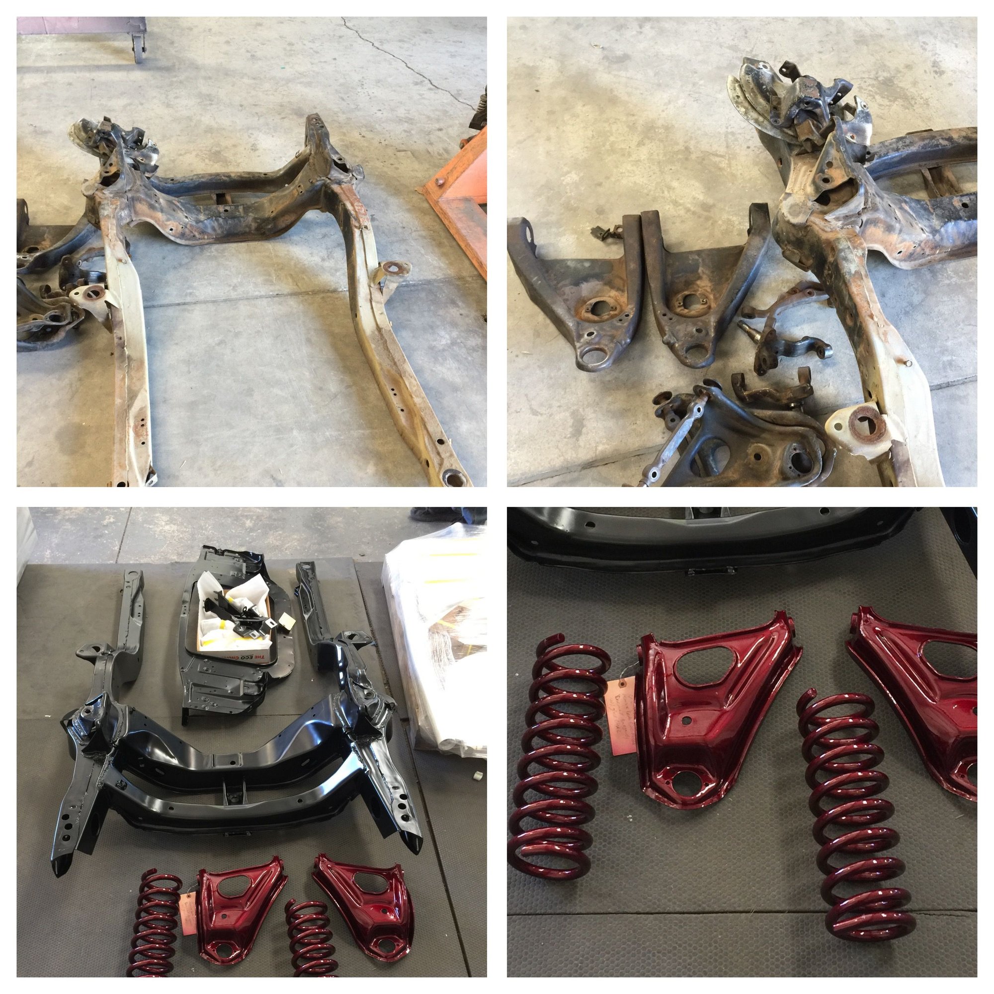

Well, it's been 24mos and yes the Maro is sitting exactly as it was 24mos ago. Maybe not exactly the same. I installed the rear disc conversion, added multi-leaf suspension, powder coated the subframe and suspension, added new tie-rods, ball joints, bushings, and upgraded the front swaybar. More pics to come.....
So now its time to get this darn thing completed (per my wife).
So get ready for the questions. And thanks in advance for all your input.

First off, Thanks Everett#2390. I'm really hoping the finished project performs as well as the subframe looks. So I'm having an LS built in either a 5.3 or 5.7 block backed up to a 4l60e. Will any 4l60e work? Do I need a certain year depending on if it's a 5.3 or 5.7?
