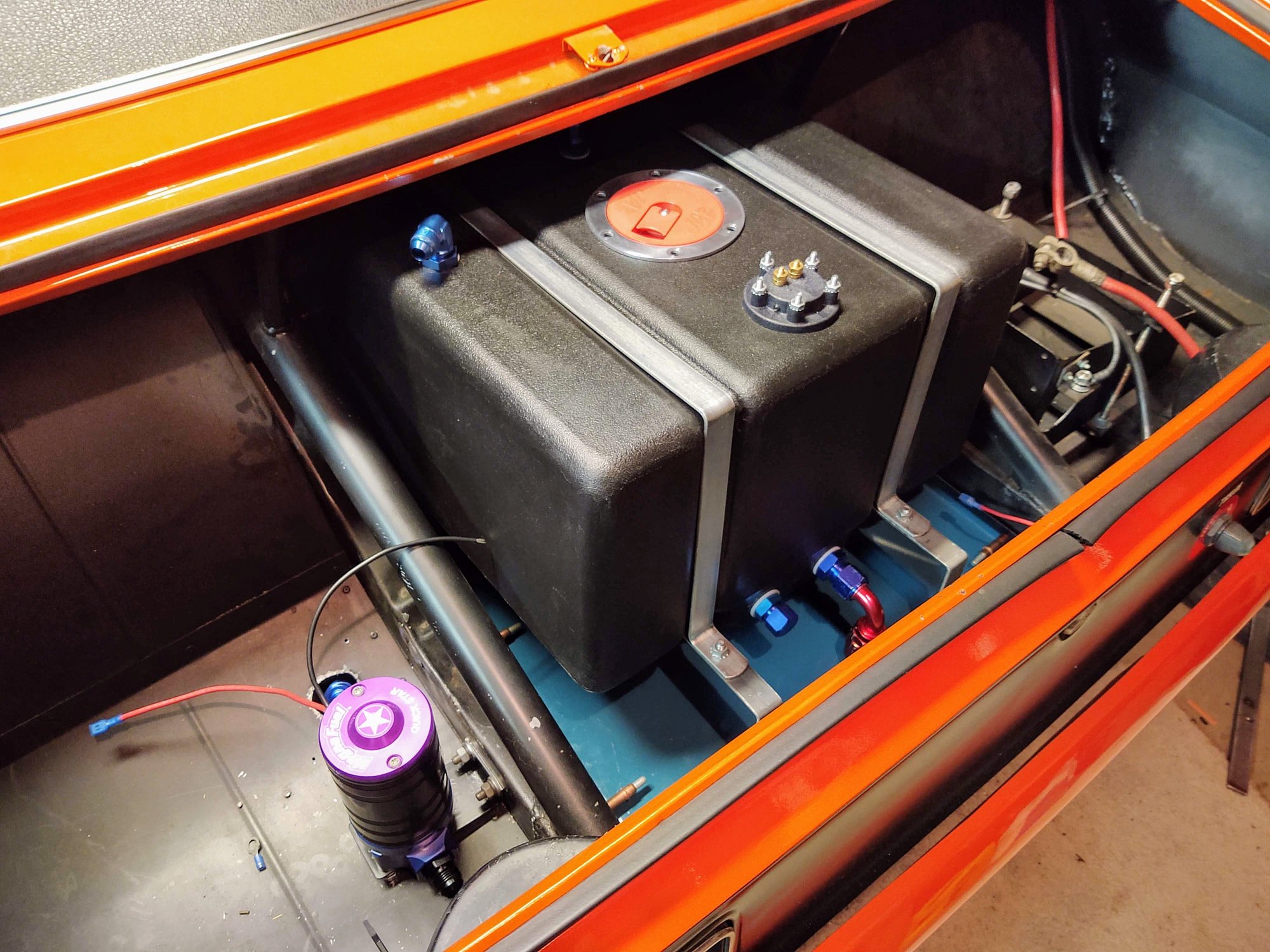

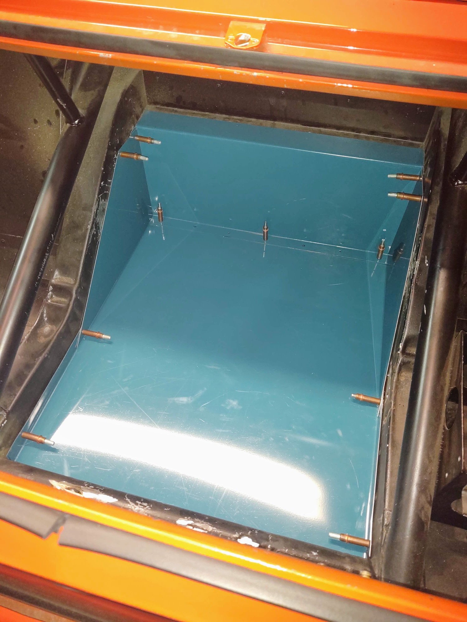

Maybe I can be of some help. I'm converting my 69 from strip car to street car and I used a 5 gallon cell. I'm replacing it with a 12 gallon cell with a sending unit and because of the size, I had to drop the fuel cell down, for clearance of the sending unit and also to move it deeper into the trunk to be able to run my fuel line, so I made what I call a belly pan.
Then I bought some 1" flat bar at Lowes and made supports for the fuel cell to sit on.
It's in the working stages yet, as I need to get some rubber seals to go around the 10AN fuel lines, run the 6AN vent line, and 8AN return line from the cell to the pump and of course, it needs all cleaned up, some beads put into the belly pan and painted.
Maybe you can do something like this?
