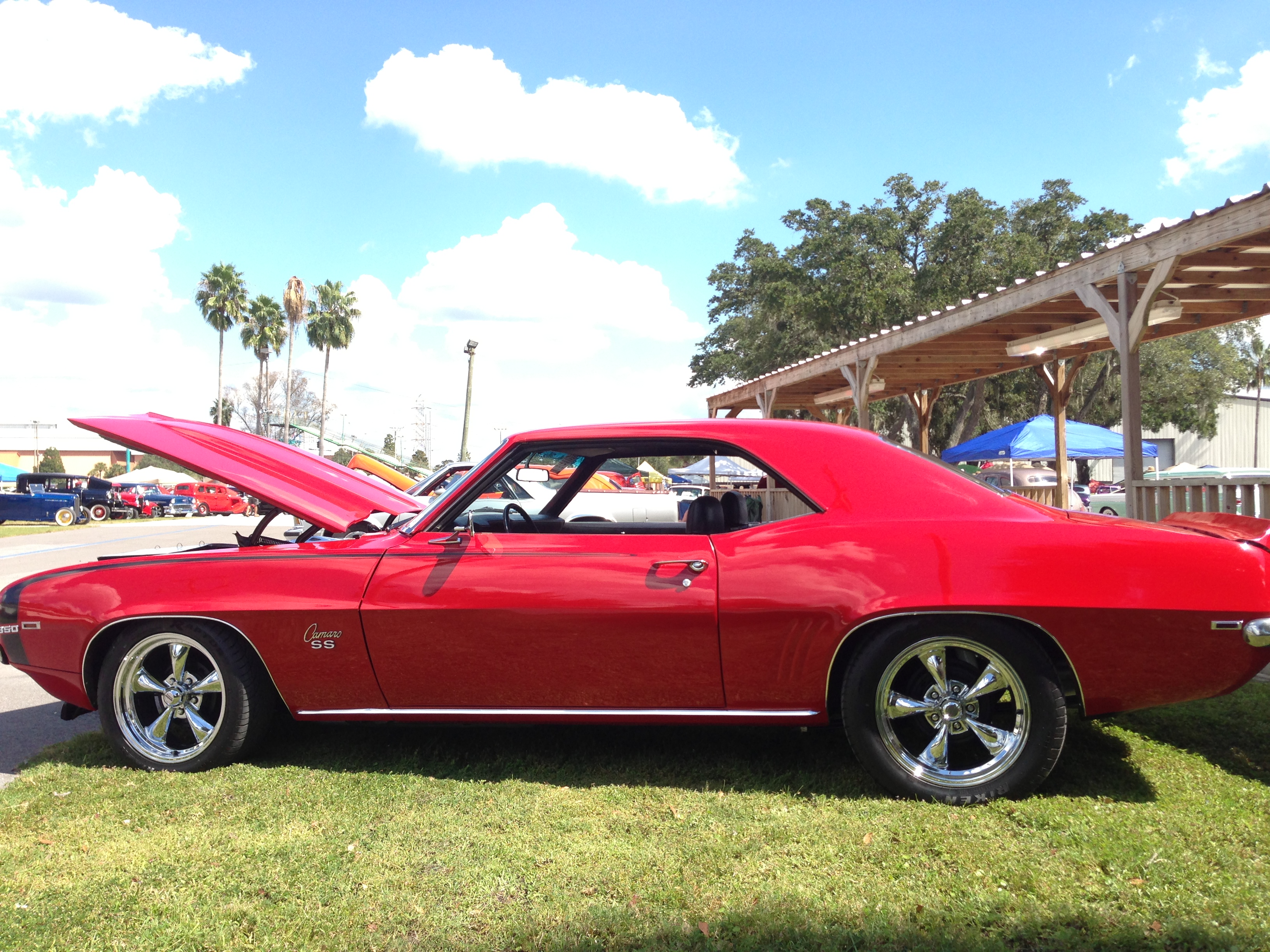

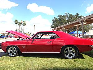

I have a 69 camaro that started life as a 6cy. it has gone through several v8 engines and Im just wondering if anyone knows if there is a difference between the 6cy wiring and one that was born with a v8 at the factory.
My stock headlight setup seems weak as do the dash lights so I was going to replace the wiring on just the lighting. will a made up loom marked as a v8 work ok. Any advise would be helpful at this point.
