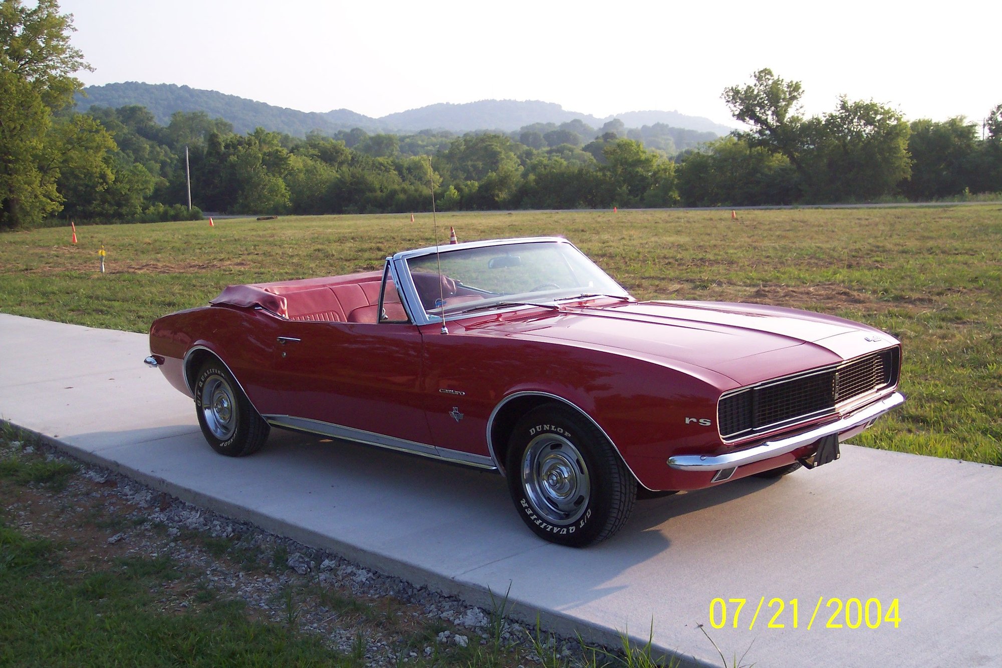

Hi, my 1967 RS Conv.
V8 has a wiring issue where it will just shut down, no power to anything. I can wiggle the wiring coming in at the fuse box and it will start. I have cleaned and lubed all the inputs but it is still happening. I know it's one wire, I just don't know which wire is the major hot wiring running the show.
Any input is really appreciated. I have had this problem for years, just dealing with it.
Thank,
Ronnie
