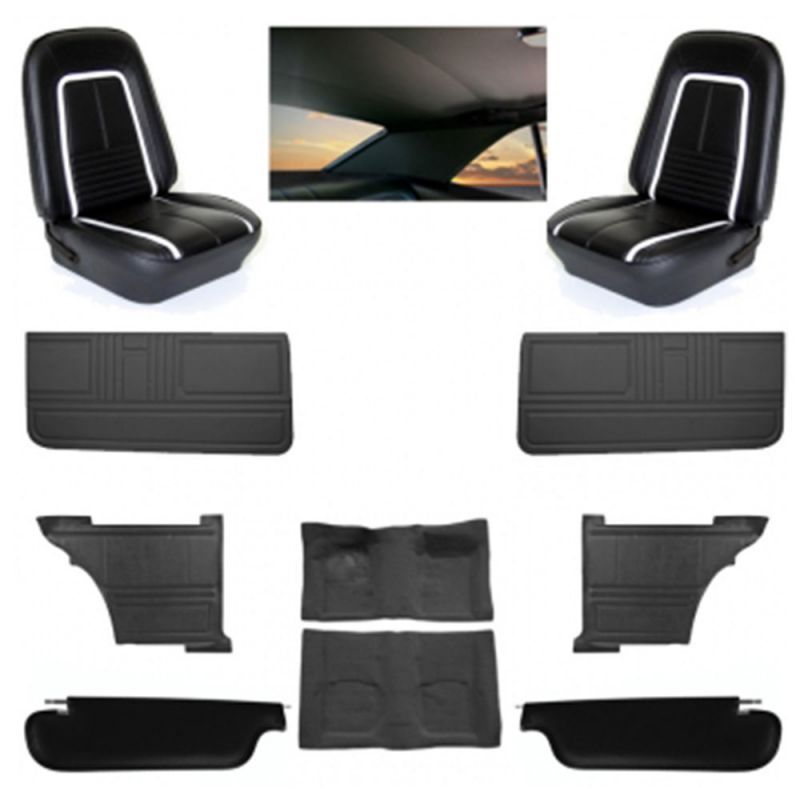

Will these door panles work?
Old May 26, 2019 | 01:04 AM
1967camaroventwindows's Avatar
Joined: May 2019
Posts: 13
Default Will these door panles work?
says 1967 Camaro Gold Series OE Style Door Panels & Rear Quarter Panels but my car is Deluxe form the factory
Old May 26, 2019 | 09:40 PM
Yes and no. The deluxe front door panels have the door release in a different spot, but that can be altered. The rear seat on a deluxe is narrower (same width as a convertible) than the standard interior seat width.
