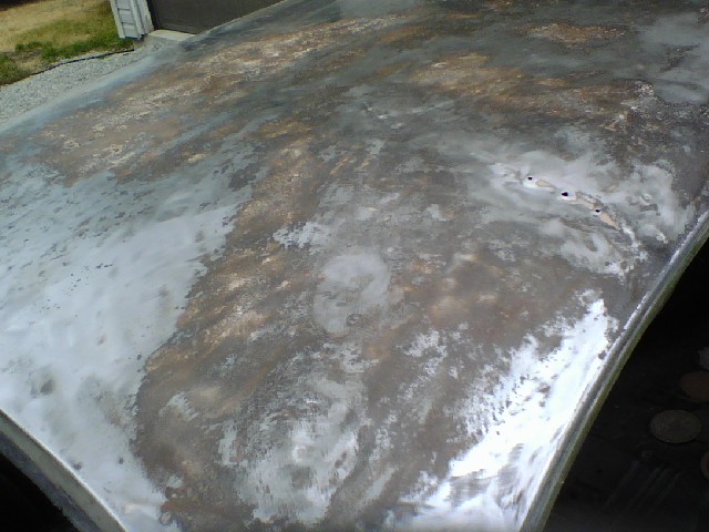

Default Before and after
It's amazing what a vinyl top can hide, here is a photo of a 1970 GTO roof that I pulled the vinyl top off of. When the owner brought me the car there were a few scuffs and small tears in the top so he wanted it replaced, the top appeared to be fine until it was exposed for what it was, a rusted out bondo filled mess. Obviously there was work done before, after pulling the headliner I found bondo "ice cicles" hanging down. This was so bad I actually had to replace the complete roof skin, and installed a new vinyl top. I am not saying yours is this bad, but just be prepared. The easiest way to remove the top is to pull the top off " I know duh" but then use laquer thinner and wax/grease remover mixed together scrub with lots of elbow grease to remove the glue, and the top pieces left behind, it is not a fun job. I never really liked vinyl tops until I installed a few, they started to grow on me and I think they look real good with the right color combo. Anyway, good luck!!
