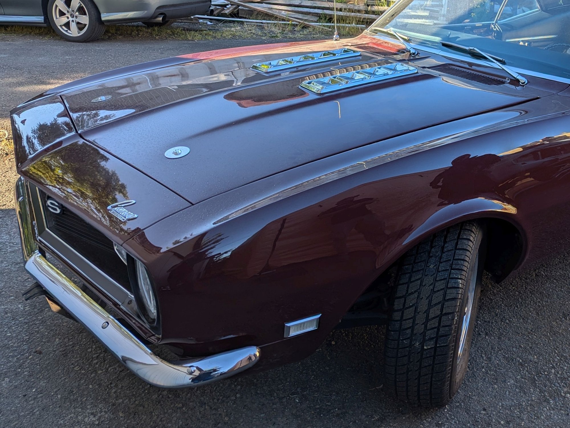

Here’s my solution: First, because I love my Camaro but do not worship it, Hood Locks. Round-key difficult-to-pick hood locks. The amateur is in a hurry, and probably is not equipped to destructively raise your hood. So, why does he need to raise your hood? The answer to that leads to part two of making it very difficult to drive away with your beautiful toy. Remove 12V DC from engine and starter. This is done with a battery disconnect between your negative lead and its attachment to primary ground, which is usually a front bolt on the engine. This BD is activated by a remote on your key-ring, so with the hood locked, and the battery isolated, it is going to be very hard to start your car. Here is what the hood locks look like on my Camaro:
They engage with receptors you install on the top of your radiator support and I have not found a reasonable way to access them, so do not lose either of the keys, main or spare.

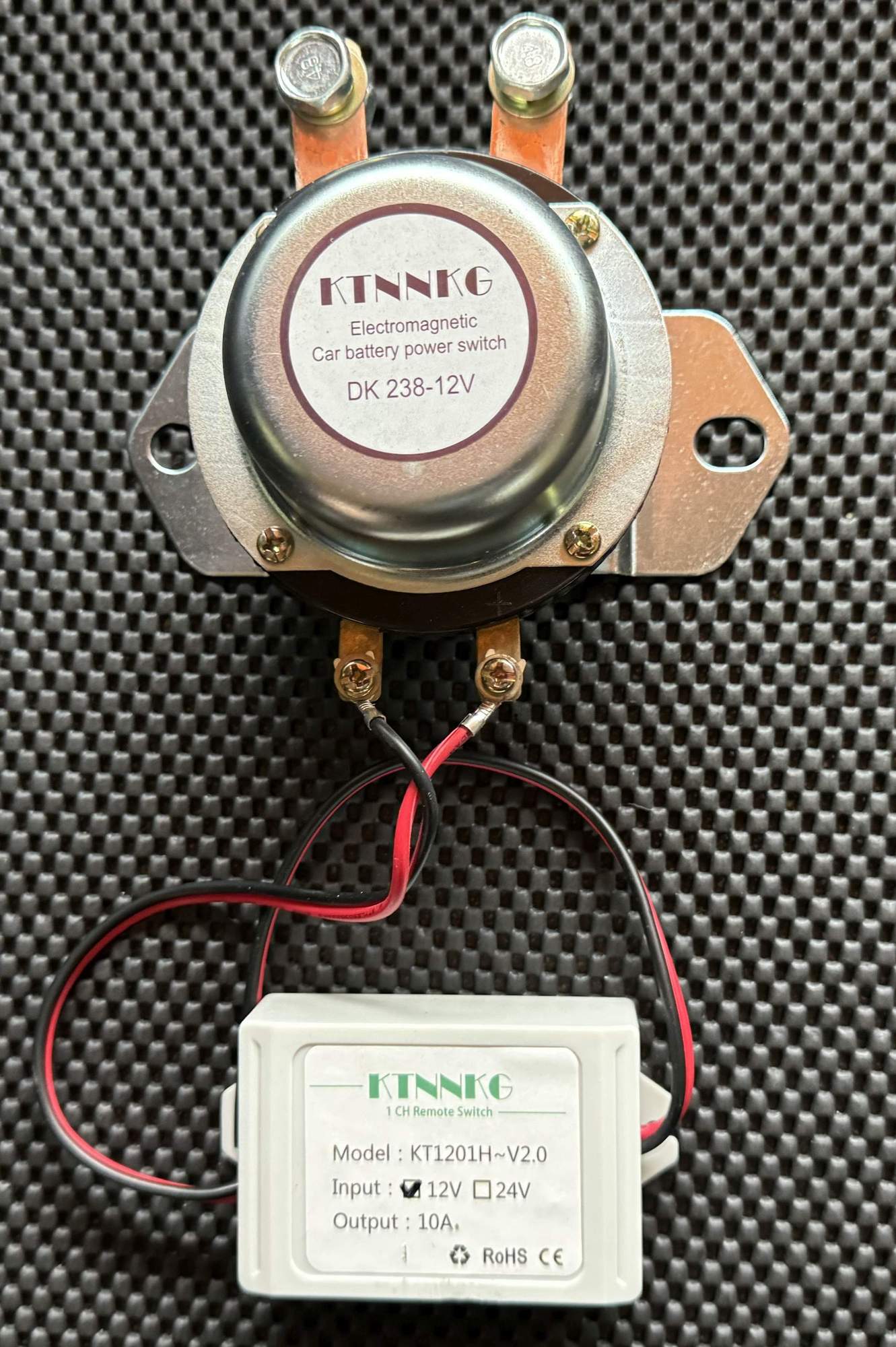

Here is the battery disconnect that I bought:
A word of caution. This device will work equally well no matter which battery terminal it interrupts, but the intelligent installer will realize that an “oops” on the negative lead as it journeys toward its connection to the frame/engine is only a source for ‘language’, whereas the positive lead “oops” between any exposed point and that same frame results in the working definition of a welder, and causes much consternation. Advice: do battery return, aka negative lead. Also, carry correct wrench to allow moving both leads under one of the two bolts, on the off-chance that this ‘made in China’ device or its fob goes on vacation.
