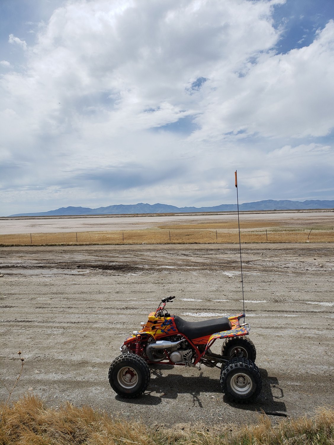

This thing (Banshee) 421 Cerval cylinder, cool head, the works, 14 to 1, runs HOT
I have 2 trans coolers, that I removed from radiator side tanks, installed in both cooler lines running to my radiator
It helps when I ride flat out
