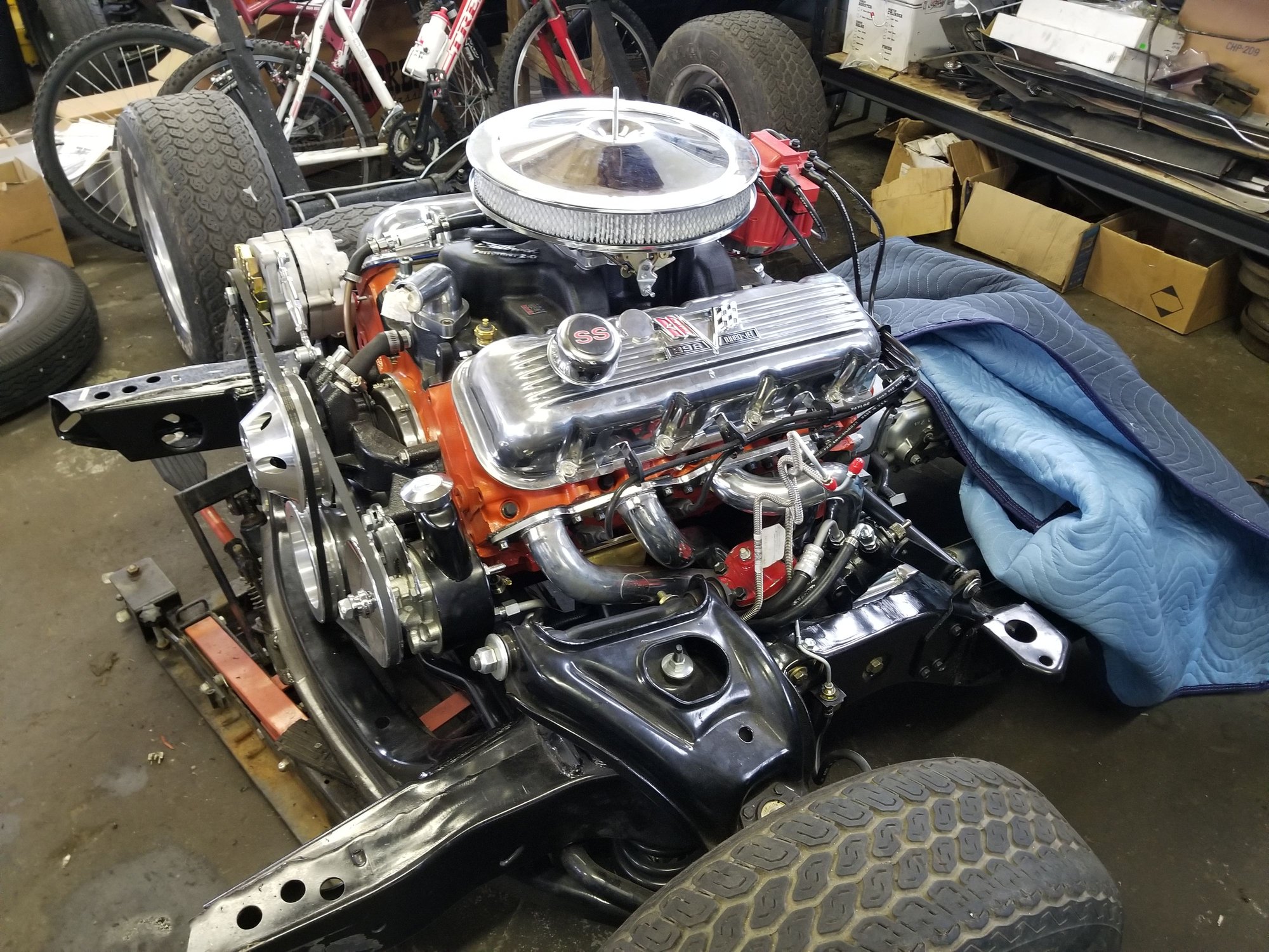

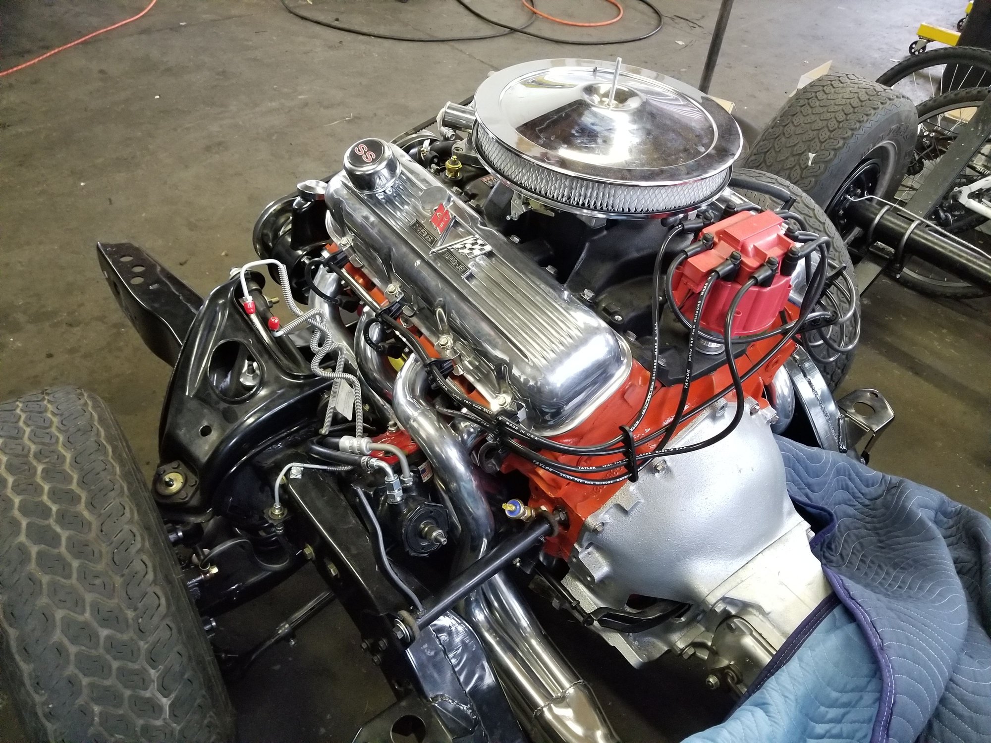

Well, in the world of “works fine, lasts a long time", we encountered this issue with my ’68 396 and solved it by buying Hooker Headers ‘Super Competition’ headers which, while mild steel, are ceramic-coated. Hooker solves this problem elegantly, by sweeping the #5 tube horizontally OVER the #7, then diving steeply down to make it under the z-bar. Here’s how that looks:
While this is a big-block and power steering box Camaro, Hooker makes a small-block equivalent. I think the number is 2207HKR but there might be a suffix to specify ceramic coatig. Not cheap but it REALLY solves the problem. Plus, by re-routing #5, the steering box gains no header-emitted heat. One possible solution...
