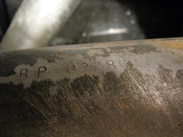

Thanks guys...how about I just give you the rear axle code: BP 0228 G2
(Being a 1968) I interpret this as 2.73 ratio, 10 bolt non -positraction. My tire are P205/70R14...not sure if this tells us the height of the tire...???
