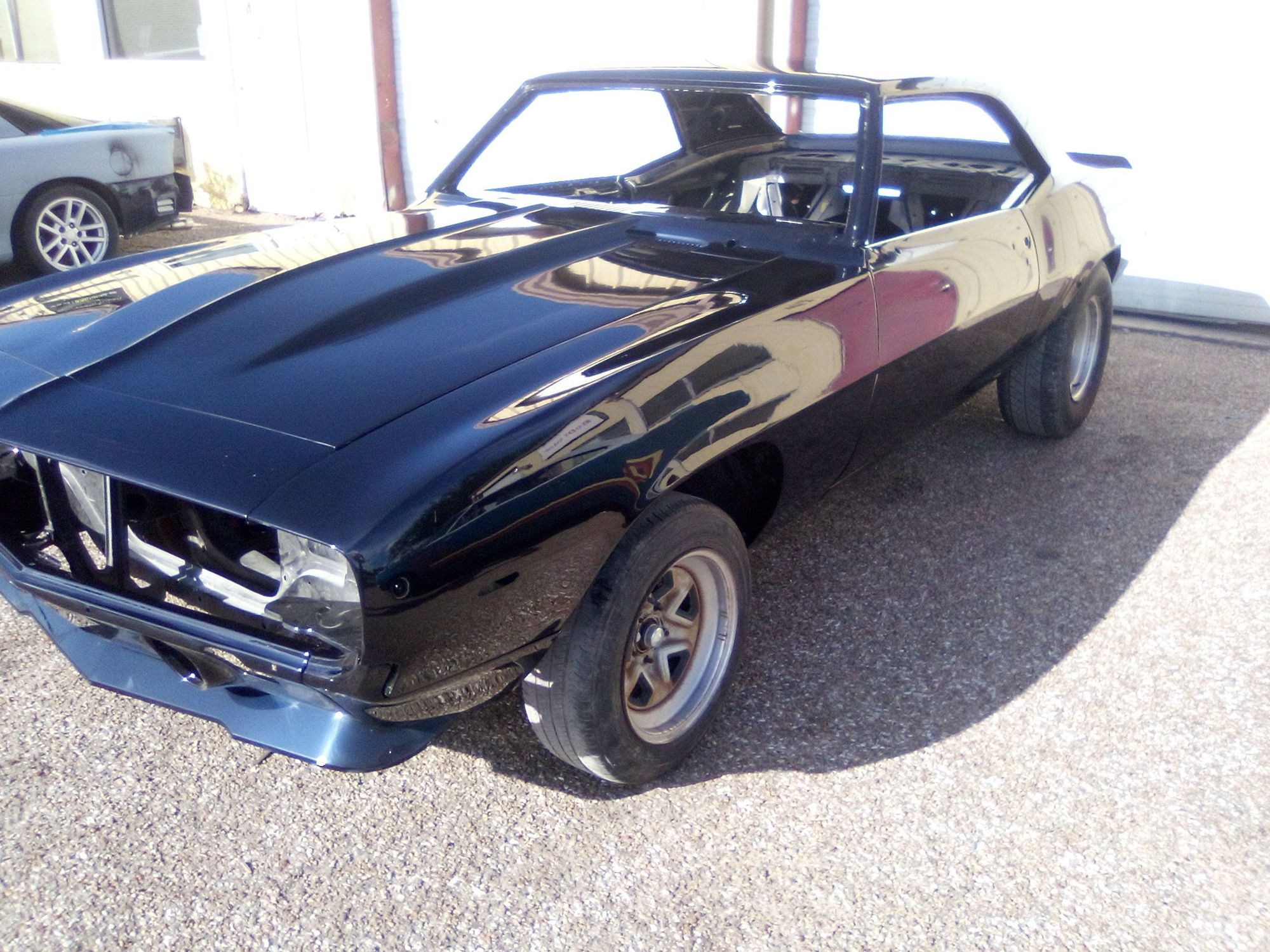

What's going on guys. I am new to the forum and hobby and finally got my chance to build my dream car. What kind of steering are you guys using on your 1st gens, rack & pinion or steering box? Also if you it is a steering box any recommended types/brands would be appreciated. 69 Camaro

Greetings, and welcome aboard! I’m a fan of 1st gen Camaros, as you can see from my user name. Your ‘69 looks right fine, with plenty of chances to make decisions.

Thx for the response (1st Gen / Gorn) and I will definitely check out your projects forum to get some pointers. Thx for the welcome, excited on this new adventure!!!! As for what I would like to do with the car I basically want it to be cruiser with at least around 500 HP with a camshaft & valve package upgrade, long tube headers, etc. keeping it simple (naturally aspirated). I will using a 2019 LT1 from a Camaro SS.
