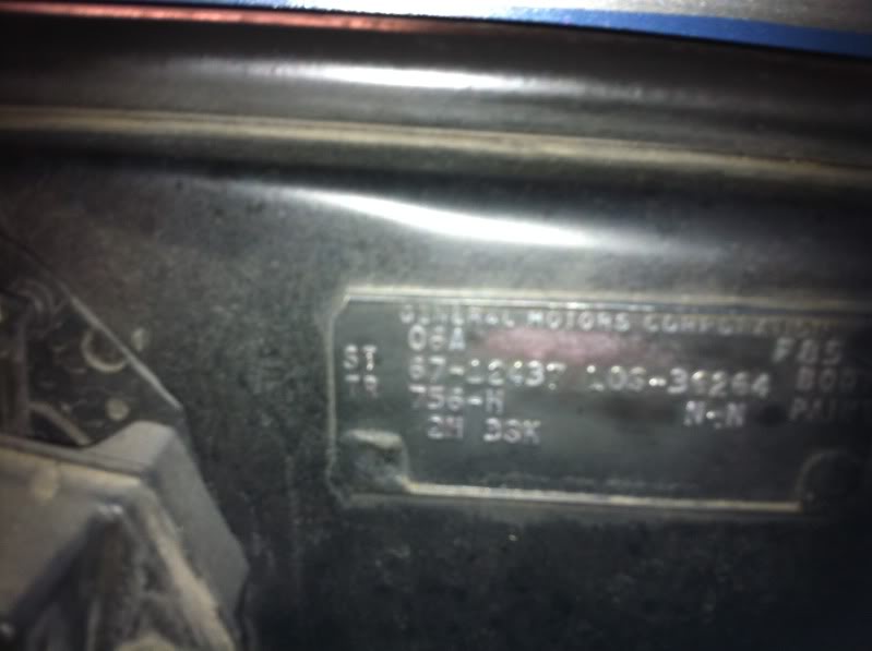

The 4 in the VIN tells it is a v8 car, the 3 means it's a coupe. That's all the VIN will tell you though.
Your engine block casting was used for the 302, 327, and 350. The suffix code in front of the passenger side head will crack it down further from there.
Trim tag: 06A is the build date. 06: June, A: 1st week of the month.
756-H is black standard interior with a bench seat.
N-N is Madeira Maroon upper & lower body color (no vinyl top).
2H: (2 is a constant) H is heater delete (hey, you're in Californi)
3SK: (3 is a constant again) S: RPO Z23 interior decor. K: RPO Z21 style trim group.
This site has a lof of helpful info: Camaro Decoding help on Chevy-Camaro.com
Come back with the suffix code off the block if you still can't decipher it.

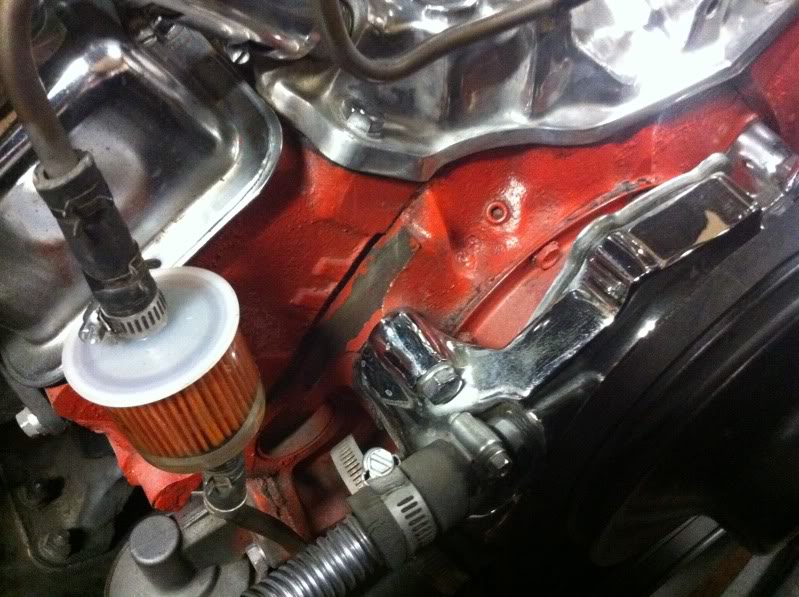

Thank for the info! Do you know anything about the camel heads? Are those 351? 383?
The best that i could read is V0601MF. Does that help? Thank you!!!

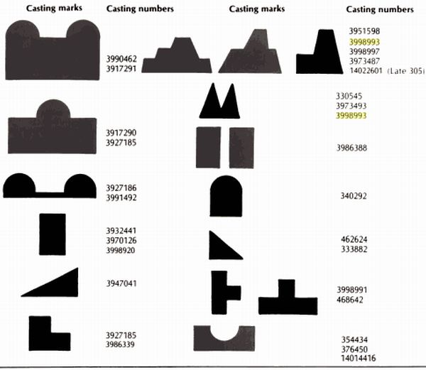

Camel back heads have rounded humps and are not squared off like the ones in the picture you posted. I was at least hoping that you had a set of smog heads w/ open chamber 194's, but it doesn't look like that's the case.

The "MF" in the engine suffix code means it's a 67 327, 210 h.p., with a 2 barrel carb., attached to a powerglide trans, and A.I.R. (it's a Calif. car).
Camel hump heads were performance heads, back in the day. And those didn't come from the factory on the engine you have. They make better paper weights when you compare them to what you can buy in today's aftermarket.

yeah those arent the right camel humps the hi pro camel humps are rounded not square.

Well i am going off of these 2 pictures and what people have told me looking at them. They do seem match with that number for the camel head markings. I have not physically removed them though to check the numbers on them. But what do you all think? Thanks!

looking at that pic of the markings the one that iv seen as the camel humps and high pros are the ones in the upper left with the taller box then the 2 round bumps
